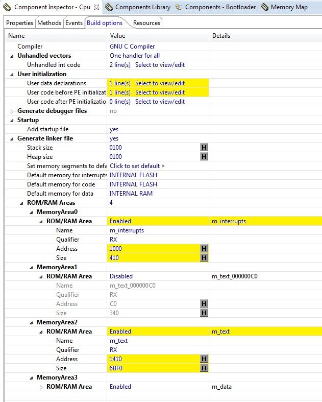

I am designing a boot loader for MKE02z64VLD2 microcontroller in Kinetis Design Studio. I have configured the Flash Memory area as per the AN 4775 documentation (IIC Boot Loader Design on the Kinetis E series). In this document, in page number 9, I found this.
So I implemented the same for my boot loader.
This is how my memory map looks like.
But when I flashed this into my board using J link debugger, This message popped up. Semihosting process monitor job failed, Java.lang.IllegalThreadStateException .
After this failed flash job, I tried to debug a simple LED blink code, but it didn't get executed. It threw me these errors.
When I inquired about my issues to experts in this field, they said I have not configure Vector Table properly, they said
Your vector table for the bootloader (at 0x00000000) is different from the application vector table. You need to set the VTOR to point to the application vector table.
Since I am an yet to be graduated Electronics Engineering student with NULL experience in Kinetis Controllers, Kinetis Design Studio or the Boot loader itself, I don't know how to configure VTOR properly. Can Someone help me configuring the Vector Table properly ?

Hello Ganesh,
I think maybe you have some mi@sunderstand about the bootloader code and the Application .
On the bootloder project, you needn't change the linker file and vector table , you need change the
linker file of APP project . For example , if the APP run from 0x1000, you need configure the linker file
m_interrupts area from 0x1000.
An important place is the jump code , when want to jump to the APP, please use the SCB_VTOR
point to the 0x1000.
There is a bootloader demo about KE02z64vll4, you can refer to the jump code :
Hope it helps
Alice
In your code you have used 'SCB->VTOR', whereas I have used 'startup' . Should I change the word 'startup'  to 'SCB->VTOR' in all instances of my code ??

Hello Ganesh,
On my code , the SCB_VTOR is not one simple variable, it is a register Vector Table Offest Register,
you can find on the cortex-m0+ Devices Generic User Guide:
Hope it helps
