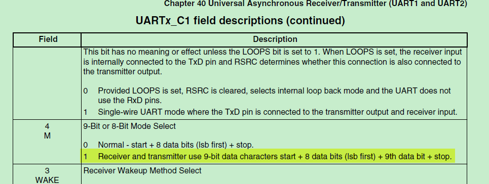

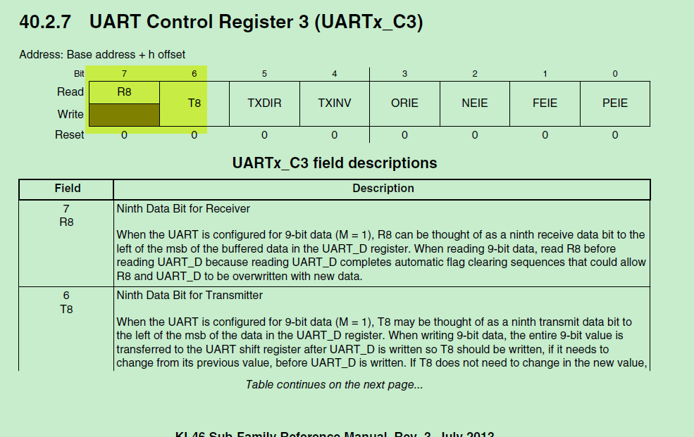

     Actually, the 9 bit is very simple, you can find the according information in the KL46 reference manual:
About the configuration, you can use the register to control it directly.
 UART1_C1 |= UART_C1_M_MASK;
Wish it helps you!

Thank you for pointing the relevant information. Based on your feedback, I have the 9-bit mode working now.
