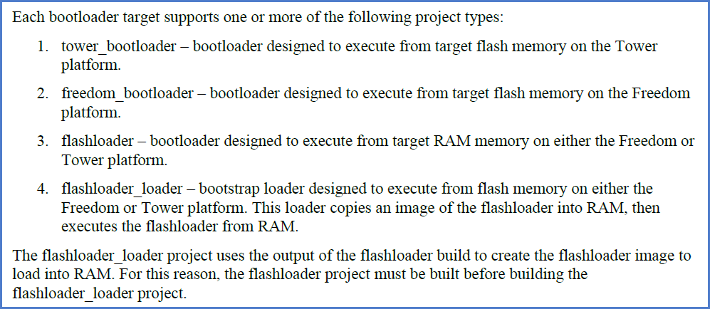

NicolasP
Hello Jorge,
KBOOT v1.2 is exactly what I need. That's perfect.
I am using FRDMk22F board (MK22F51212 target).
I don't understand what are the differences between flashloader, flashloader_loader and freedom_bootloader targets.
My guess :
- flashloader : runs in RAM and is able to erase/program the full FLASH memory once.
- flashloader_loader : runs in FLASH and can erase/program the FLASH memory above a predefined address multiple times.
- freedom_bootloader : flashloader_loader for FRDMK22K board
Am I right ?
Nicolas

Jorge_Gonzalez
Hello Nicolas,
Not exactly, read the definition in KBOOT release notes:
(C:\Freescale\FSL_Kinetis_Bootloader_1_2_0\doc\Kinetis Bootloader v1.2.0 Release Notes.pdf)
So in summary:
-​ Bootloader (tower or freedom): Bootloader firmware that resides in Flash and can be used multiple times.
- Flashloader_loader + Flashloader: The firmware you get from the "flashloader_loader" project can be programmed to the K22 with an external tool (Jlink, U-Multilink, OpenSDA,...) and you get a one-time loader. As stated in the text box, the flashloader project must be built first.
I hope this clarifies.
Regards!
Jorge Gonzalez

NicolasP
Hello Jorge,
That's perfectly clear. I should have read twice.
Thanks a lot for your support.
