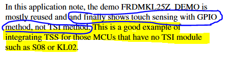

The application note in question refers to a method of creating a "TSI like" function using GPIO and a HW timer. It is a "poor-man's" method of emulating TSI when the TSI peripheral is not available (eg. in very low end KE or KL parts). It has HIGH SW overhead and LOWER performance than the TSI peripheral (like bit banging a UART when you don't have a real one available).
The technique will certainly not be of any interest to you if you are already worried that real TSI will not be adequate: It will not make things faster or more more powerful but will consume unnecessary CPU power in a system where you are already worried about performance.
Since GPIOs already have the edge interrupts that you need turning a GPIO into a slow TSI has no advantage. The application note DOES NOT turn a TSI only pin into a fast GPIO....

Hello Mark,
I'd like to ask, have you actually looked at those source files I'm looking for?   I'd like to know where you got your "conclusion" / statement from.
I beg to disagree with your statement, because the MCU KL25Z used in the example has TSI (Touch Sensor Interface) with 16 touch sensing capable channels (just like my target MCU KL28Z).
And so that's why the AN4637.pdf's has the title:
"Integrating Touch Sensing Software (TSS 3.0.1) on Kinetis L Using GPIO Method"   using that MCU KL25Z touch capable pins and instead of regular "scanning" the pin with TSS method, they convert such touch capable pin to generic GPIO input pin.
Please provide basis for your statement that it is the OTHER WAY AROUND - the touch capable (TSIO_ch#) pin is just used as probable "default" generic GPIO input - WHICH IS ACTUALLY THE METHOD I WOULD LIKE TO LEARN.
You see not all GPIO pin is Touch capable in any MCU; only 16 out of 80 in both MKL25Z and MKL28Z for a fact, as TSI0_ch0 through _ch15).
So someone writing a whole application note is a waste of "TSS" technology when it is already built-in in the MCU.
Now the trick is to fall back and make that touch capable TSI0 module or not even use that built-in technology and make any GPIO trigger by touch.   How?  As a generic ANALOG input?   I can do that and I also have 6 analog inputs that go to the internal ADC.   But I would like the actual source code to see an example to get an idea how they do it.
MI

The sources are confidential to Freescale/NXP and they will neither give them to you nor to me .
The application note's introduction (plus various additional details in the general text) makes things quite clear to me:
You could try reverse engineering the library using IAR if you still have doubts. If your IT department won't let you do it in the company just do it on a home PC - this is the typical engineering method used when IT department red-tape gets in the way of progress.
Your KL28's TSI inputs can be configured as either TSI inputs (using the DMA method as recommended by NXP and myself you will get zero overhead operation with a resolution of well over 1kHz which is adequate for an HMI interface) or as HW interrupt (if you prefer to replace touch keys by mechanical ones).
