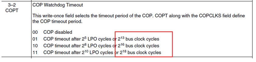

The watchdog clock provides BusClock(24MHZ),How to calculate the watchdog timeout?Is there a formula?
1,396 Views
Hello 东伸 韩 ,

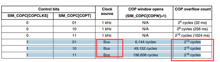

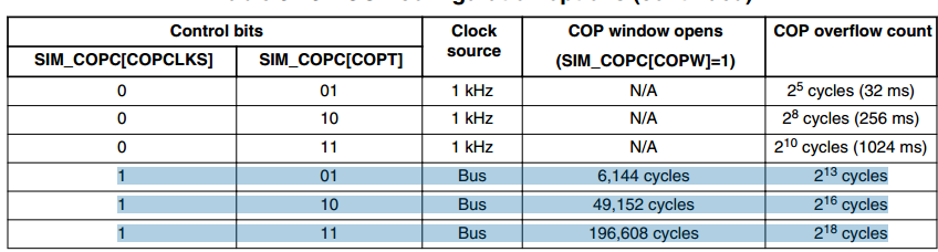

The register of COP Control Register (SIM_COPC) ->COPT determines  watchdog timeout.
Also from the table you provide can know it .
