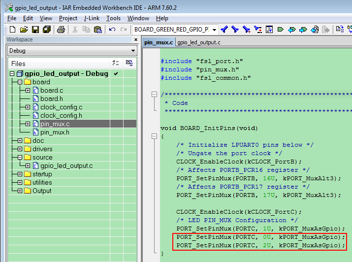

does someone have a code for the activation of all RGB Leds on the Kl82z?
I'm trying to get it working, but the example only gets the red one working. And the libs are not that I can understand what to do to get the other two working.

void delay(void)
    volatile uint32_t i = 0;
    for (i = 0; i < 800000; ++i)
        __asm("NOP"); /* delay */
 * @brief Main function
int main(void)
    /* Define the init structure for the output LED pin*/
    gpio_pin_config_t led_red = {
        kGPIO_DigitalOutput, 0,
    gpio_pin_config_t led_green = {
    gpio_pin_config_t led_blue = {
    /* Board pin, clock, debug console init */
    BOARD_InitPins();
    BOARD_BootClockRUN();
    BOARD_InitDebugConsole();
    /* Print a note to terminal. */
    PRINTF("\r\n GPIO Driver example\r\n");
    PRINTF("\r\n The LED is taking turns to shine.\r\n");
    /* Init output LED GPIO. */
    GPIO_PinInit(BOARD_LED_GPIO, BOARD_LED_GPIO_PIN, &led_red);
    GPIO_PinInit(BOARD_LED_GREEN_GPIO, BOARD_LED_GREEN_GPIO_PIN, &led_green);
    GPIO_PinInit(BOARD_LED_BLUE_GPIO, BOARD_LED_BLUE_GPIO_PIN, &led_blue);
    while (1)
        delay();
        GPIO_TogglePinsOutput(BOARD_LED_GPIO, 1u << BOARD_LED_GPIO_PIN);
        delay();
        GPIO_TogglePinsOutput(BOARD_LED_GREEN_GPIO, 1u << BOARD_LED_GREEN_GPIO_PIN);
        delay();
        GPIO_TogglePinsOutput(BOARD_LED_BLUE_GPIO, 1u << BOARD_LED_BLUE_GPIO_PIN);

Hi Ulrich,
Please add "LED PIN_MUX Configuration" code for other two LED pins.
Robin
