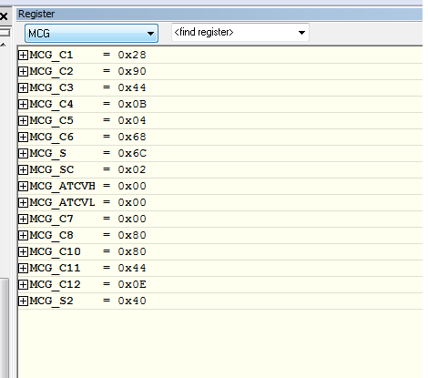

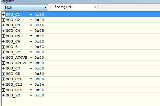

For TWR-K70F120M clock should be 120 Mhz. But I get 150 Mhz.
mcg_clk_khz = 150000
core_clk_khz  = 150000
periph_clk_khz  = 50000
I have another IAR project. In the second project I get the right value - 120 Mhz.
mcg_clk_khz = 120000
core_clk_khz  = 120000
periph_clk_khz  = 60000
Comparing these functions - sysinit() I didn't find any difference. What could be a problem?

Thank you for the answer. MCG register is set in
/* Initialize PLL0 */
/* PLL0 will be the source for MCG CLKOUT so the core, system, FlexBus, and flash clocks are derived from it */
mcg_clk_hz = pll_init(OSCINIT,   /* Initialize the oscillator circuit */
                             OSC_0,     /* Use CLKIN0 as the input clock */
                             CLK0_FREQ_HZ,  /* CLKIN0 frequency */
                             LOW_POWER,     /* Set the oscillator for low power mode */
                            CLK0_TYPE,     /* Crystal or canned oscillator clock input */
                             PLL_0,         /* PLL to initialize, in this case PLL0 */
                             PLL0_PRDIV,    /* PLL predivider value */
                             PLL0_VDIV,     /* PLL multiplier */
                             MCGOUT);       /* Use the output from this PLL as the MCGOUT */
        /* Initialize PLL1 */
       /* PLL1 will be the source for the DDR controller, but NOT the MCGOUT */
       pll_1_clk_khz = (pll_init(NO_OSCINIT, /* Don't init the osc circuit, already done */
                                 PLL_1,        /* PLL to initialize, in this case PLL1 */
                                 PLL1_PRDIV,    /* PLL predivider value */
                                 PLL1_VDIV,     /* PLL multiplier */
                                 PLL_ONLY) / 1000);   /* Don't use the output from this PLL as the MCGOUT */
The defines in both projects the same
#define OSCINIT 1
#define OSC_0 0
#define CLK0_FREQ_HZ       50000000
#define LOW_POWER 0
#define CLK0_TYPE           CANNED_OSC
#define PLL_0 0
#define PLL_1 1
#define PLL0_PRDIV     5
#define PLL0_VDIV       24
#define PLL_ONLY 0
#define PLL1_PRDIV     5
 #define PLL1_VDIV       30
#define MCGOUT 1
So MCG should the same. When I compare the MCG registers – it different.
