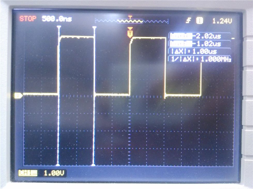

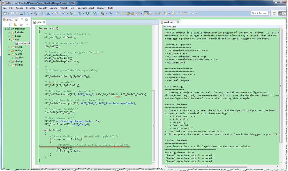

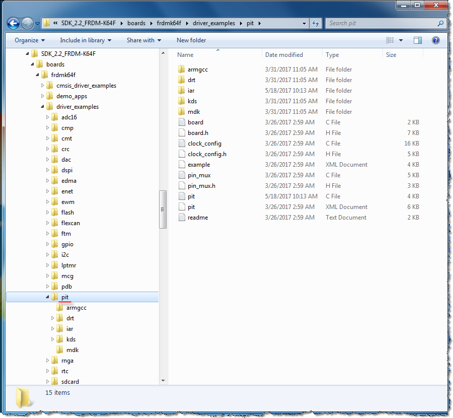

The red LED can toggle every 1us, test the pit demo in SDK_2.2_FRDM-K64F. (...\SDK_2.2_FRDM-K64F\boards\frdmk64f\driver_examples\pit)
