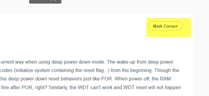

kerryzhou
Hi Sheng Zhang,
   You can find the correct answer in the reply post right corner.
Kerry

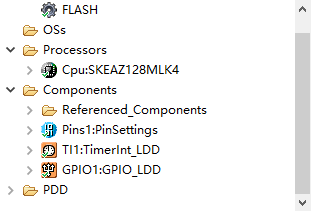

zhangsheng

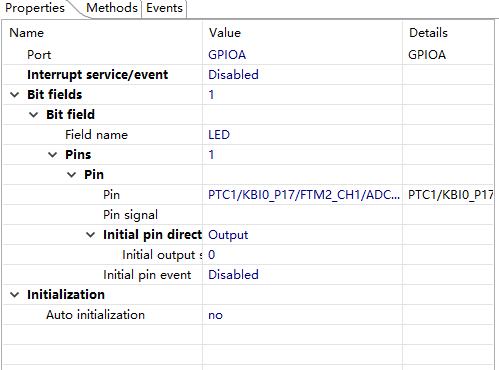

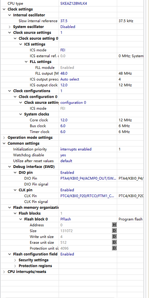

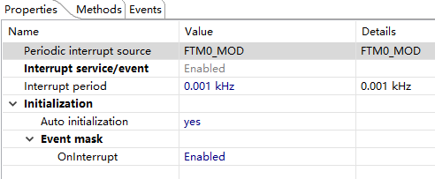

Sorry I have no idea how to upload the project.  LDDs in use:
CPU setting:
Timer setting:
PGIO setting:
FLASH Setting:
After rebooting the system the led will not flash while it can flash in debug mode. so does my complex project.

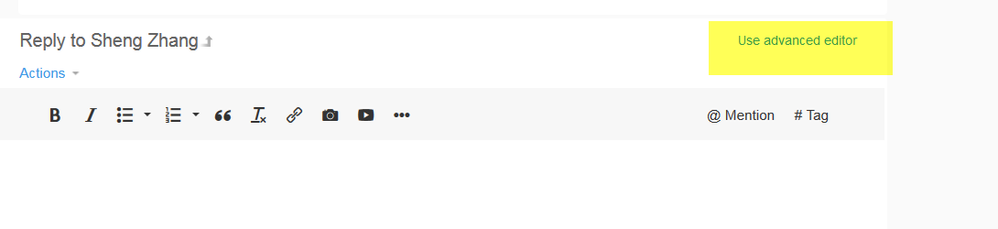

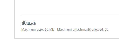

     Please attach your project which can work at debug mode, but can't work after download to the flash.
   About attach the CW project, please zip it.
   Then reply me with "use advanced editor", then you will find the Attach button.

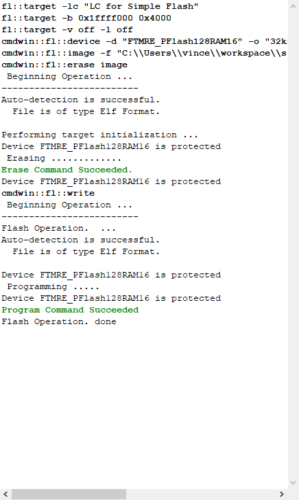

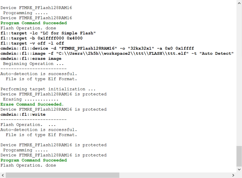

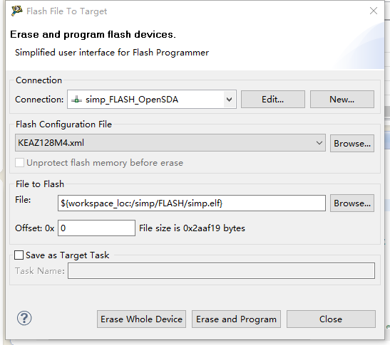

2.How you flash.elf to KEA128 without the IDE?
I was using the flash programmer in  CW10.5, flash file to target -> erase and flash. This is the flash log.
