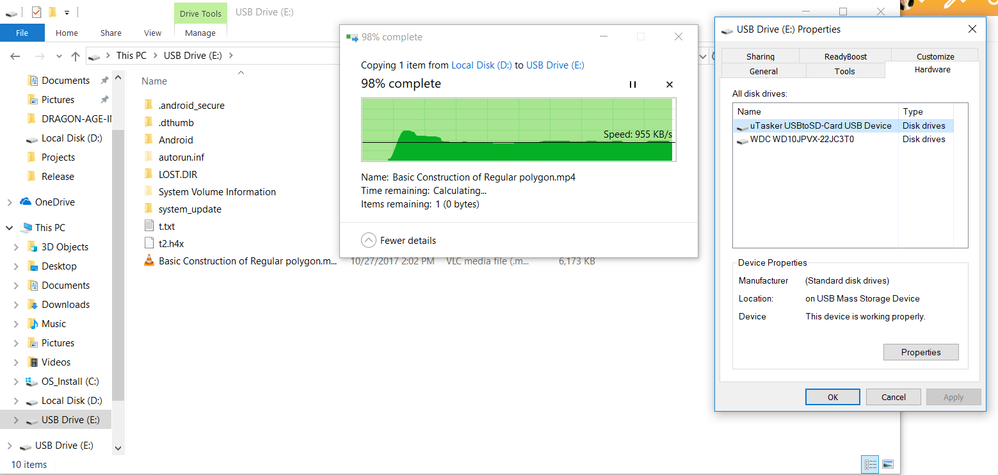

How to Fix uTasker USB to SD Card Stuck at 98% when Copying File?
Board:       Teensy 3.5
SD Card:   8GB Sandisk SDHC
The Copying speed is moving while the Copy progress stucks at 98%.

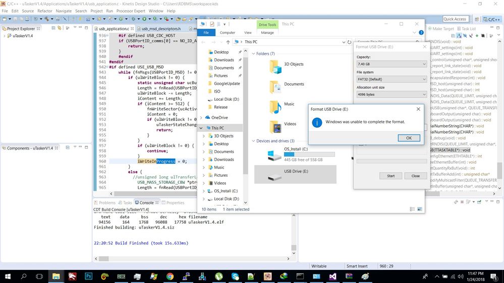

alresarena
Yes i can format the sd Card using SdCard slot on PC  and the sdcard is working but when I put the Sd card on Teensy 3.5 with updated utasker usb_application.c code, the sd card shows unformatted on PC

alresarena
Hello Sir Mark :smileyhappy: When I try to format it shows  unable to format message.

mjbcswitzerland
Specialist V
Alres
Can you format the SD card in the SD slot of the PC?
Make sure that write-protection is not enabled.
Mark

alresarena
Answer: It will not happen when I try to copy a file  with a size of 2MB or below it didn't stuck but when I try to copy 3MB or higher like on the screenshot which is 6MB it will stuck at 98%

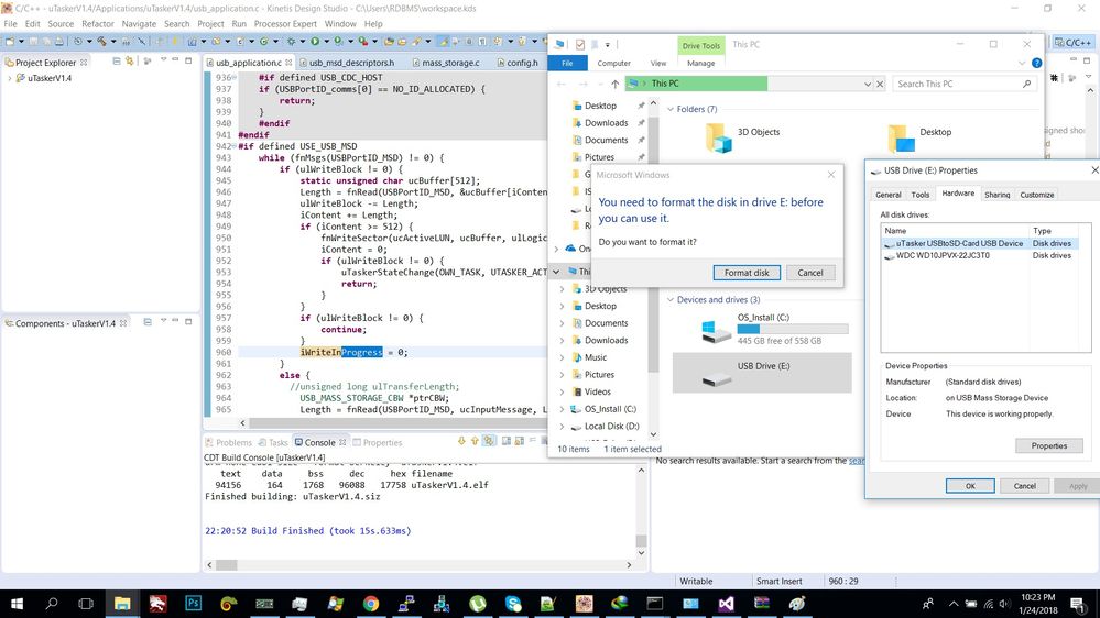

alresarena
Hello Sir Mark :smileyhappy: I tried your updated code usb_application.c but unfortunately the SD Card that is mounted on the PC became unformatted even the SD Card itself is physically formatted with FAT32.

mjbcswitzerland
Specialist V
Alres
I doubt that the update influences the state of the card since it effects only writes and not reads.
Try formatting the card as the PC suggests and perform the tests again.
During developments it makes sense to have a small number of SD cards that you can change in case anything goes wrong and also so you can repeat tests to see whether behavior is consistent or random.
