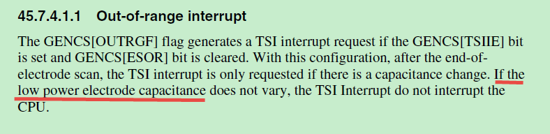

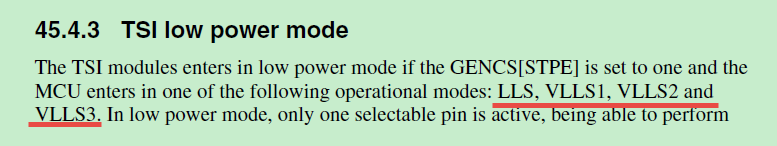

K10_50MHz TSI module normal interrupt (TSI0_GENCS[TSIIE]) related to two types of interrupt: End of Scan interrupt and Out of Range interrupt.
The Out of Range interrupt is only available in TSI low power mode.
The TSI mentioned low power mode only supports LLS, VLLSx, not includes the VLPS.

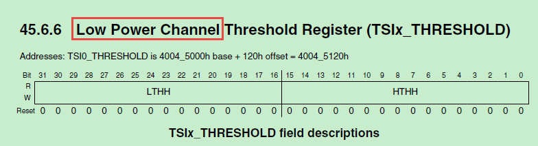

The Out of Range interrupt related threshold register only works for TSI low power mode
The Out of Range interrupt doesn't work at VLPS mode.
While, the End of Scan interrupt still work and can wake up the K10 from VLPS mode.
In general, the TSS library using TSI out of range interrupt to wake the chip from low power mode.

I'm able to wake up K20 from LLS mode with TSI, however, in that case only one electrode is active, which doesn't meet my system requirements.

I configured my system for LLS mode, and I'm able to wakeup with touch input, however the problemm is only one elctrode is active in LLS mode.
My requirement is that all TSI electrodes should be active in Low Power Mode. That's why I must configure the system to enetr and leave VLPS with touch input.
