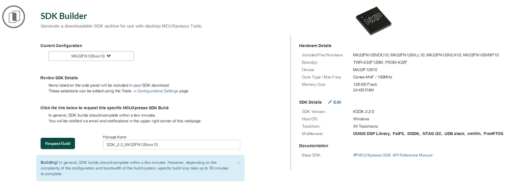

I have the smaller slower version of the MK22F chip set on my custom board the MK22F12810 chip. I'd like to get a USB stack running on this chip, but there isn't a usb platform build for this chip. I've successfully used the FRDM-K22F board and ran a simple keyboard hid usb application. Is there a way I can modify the MK22F51212 platform, so I can build and run the same keyboard demo on the MK22F12810 chip? Or is there another approach I should be doing to get this kind of application running?

Customer could visit here to create MCU SDK software package for MK22FN128xxx10 product:
The USB demo project located at below default path:
..\SDK_2.2_MK22FN128xxx10\boards\frdmk22f\usb_examples
Thank you for the attention.

brendanmerna
Ma Hui,
I was able to build this and found the USB project. But, don't I still need a library to build with this project?
-Brendan

Hui_Ma
Hi Brendan,
The USB stack was embedded in MCUXpresso SDK software package. Thanks.
Ma Hui
