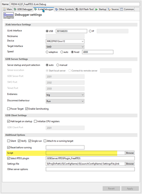

We have some projects that use the MCUXpresso IDE for building, flashing, and debugging.
One of our projects requires multiple steps to flash the target because it uses both internal and external flash parts.  We have a flashing script that works for us from a command line interface using JLink commands and would like to port it into the MCUXpresso setup so that we can call it to flash the target when we want to debug.
I have tried multiple things to get it to recognize my script but I am doing it wrong somehow.  First, I cannot seem to replace the script.jlink file that is in the project because it just gets overwritten with the default values.  I also tried editing the debug configuration and having the path to my flashing script in the Script field in the JLink Debugger tab, but that generates errors as if it is looking for some other kind of file than my flashing script.
Please advise me as to how to get MCUXpresso to use my script and execute it such that the JLink commands will flash my target in the debug startup sequence.  Thank you.

If you want to program multiple binary files, you can do this directly in the debugger/gdb commands/settings, e.g. see
https://mcuoneclipse.com/2022/11/01/loading-multiple-binary-files-with-gdb/
Additionally, if you want to do low level stuff, you can do this with the J-Link Script files: https://wiki.segger.com/J-Link_script_files
The script can be passed in the MCUXpresso IDE here:
I hope this helps,
Erich
