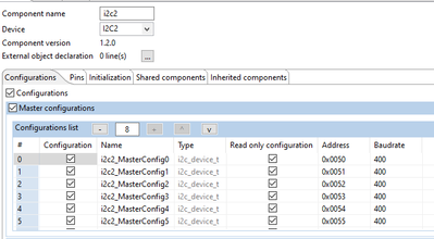

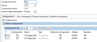

I have two boards that use similar software but different I2C configurations. I'm trying to use the same source files for both boards but need two Processor Expert builds. One build has two masterConfigs while the other has 8 with no overlap.

Frank_Z
I found I can create two Generator Configurations, each with i2c0 and i2c2 components defined as necessary and enabled/disabled per configuration.
Issue I see is that PE generates files based on the component name, thus making two sets of i2c0.c/h files. I can't SVN two versions of the same filename. I can base the component names on the configuration, but then I can't tell which .h files to include.
There is supposed to be a PEcfg_ defined per configuration but I can't find them.
