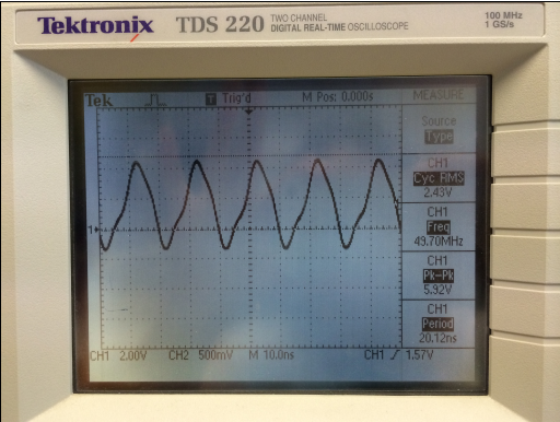

Hi, guys. I am a newer about ARM processor. How could I output 50MHz square waveform by using FRDM-K64F since the maximum frequency of CPU is 120MHz. Thanks in advance!

Hi Gloria,
Using the FRDM-K64F Freedom board with KDS_3.0 and KSDK_1.2.0 and the gpio_example_frdmk64f as a test project I did the following to get a 50MHz clock out on the PTC3 (I used o-scope on pin J1 pin 16 header and ground on J2 pin 14).
Added to main.c (file attached too....look for "//DES" to find modifications:
#include "fsl_sim_hal.h"
In main function add:
    PORT_HAL_SetMuxMode(PORTC, 3U, kPortMuxAlt5);//DES PTC3 = CLKOUT
    PORT_HAL_SetDriveStrengthMode(PORTC, 3U, kPortHighDriveStrength);//DES high drive strength
    CLOCK_HAL_SetClkOutSel(SIM, OSCERCLK0);//DES CLKOUTSEL=0x4=OSCERCLK0

gloria
Hi David, many thanks for your help. I have tested the signal by o-scope. The output voltage is so small from J1 Pin16. Is there any way to change the output voltage from the pin?

gloria
Hi Avlia,
Thank you very much. Your advise is soooooo helpful.
Do you know whether the internal reference clock used in previou project is a sin wave or a square wave. Because I use a 100MHz oscillscope and what I see in the oscilliscope from PTC3 is more like sin wave. I am not sure if it is caused by oscillscope. Many thanks!

isaacavila
Hi Gloria,
I also used a 100 MHz Oscilloscope so I had same results as yours. It is more like a sin wave.

gloria
Hi Isaac,
Do you mean the internal reference clock is actually a sin wave instead of square wave? Sorry for my so limited knowledge of ARM processor.

isaacavila
Hi Gloria
Actually, reference is square wave but we both see more like a senoidal due to pin's speed on toggling its state.
(And of course, due to oscilloscope's sampling frequency).
This speed is limited and when toggling pin's state it takes time to reach the opposite state and that is why we saw like a sine-wave (it could be more like a triangle-wave)

gloria
Hi Isaac,
I get confused about the waveform.
Why the lowest voltage of the waveform is a negative value and the waveform is not symmetric as normal?

egoodii
Senior Contributor III
I think you will have to agree that a 100MHz scope-bandwidth is only twice the 'frequency of interest', so how could you expect to see anything more than the fundamental, the sine-wave of 50MHz?  As the 'sum of odd harmonics', you would need at LEAST the 3rd (150MHz) and 5th (250MHz) harmonics to pass-thru 'relatively undiminished' to start to look square.  And working this close to the 'max range', the scope is probably also 'filling in' a sine-wave from the points it CAN read, hence generating a waveform that exceeds the rails.  Of course there I am ASSUMING that this 50MHz is NOT driving an unterminated trace, which would of course add its own 'ringing' to the situation!  Kinetis silicon is certainly capable of clean, fast edges -- see my 500MHz-scope picture in:
Confirming K22F Clock Frequency
Although not the 'square wave' I expected in that shot, I got said square-wave with 'better code', showing a sequence of 10ns high and low intervals.  The point is that signal rise/fall-time can be about 5ns.
1st, 3rd & 5th make 'red' waveform:
Note also how the 'pure sine wave' (green) is at a higher peak-to-peak than the 'final' +/-1 'squared off' wave.
