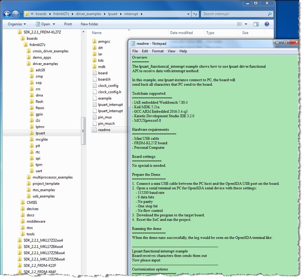

How can I use serial communication?
Which ports could I use and how can I use? Lines, library, all.
Both serial ports that the manual explain works, but isn't functionally for me, because I can't save or send the data that have been sent or wrote.
I didn't found any program or help in other documents/this community.
I hope that someone could help me, thanks!

Hi Tiago,
Considering that you have download the SDK v2 in your last question.
Please test these examples on your FRDM-KL27Z board.
Robin

Hi Tiago
UART: http://www.utasker.com/docs/uTasker/uTaskerUART.PDF
KL27 has 1 UART and 2 LPUARTs: http://www.utasker.com/kinetis/UART_LPUART.html
For the pins that can be multiplexed, check chapter "Signal Multiplexing and Signal Descriptions" of the user's manual
Working references: http://www.utasker.com/kinetis/FRDM-KL27Z.html / http://www.utasker.com/kinetis/Capuccino-KL27.html
Free code and KL27 simulation: https://github.com/uTasker/uTasker-Kinetis
Video for DMA UART operation: https://youtu.be/dNZvvouiqis / https://youtu.be/GaoWE-tMRq4
