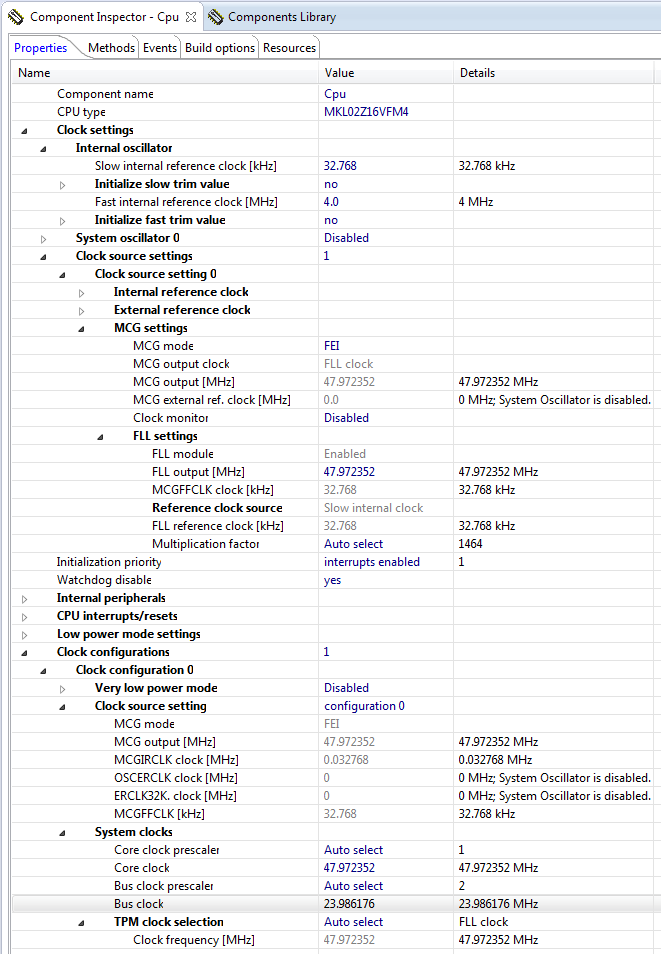

Derrick
Hi Clive,
I suggest comparing your Processor Expert screen to mine (from CodeWarrior v10.6).  There may be something slightly different.  As I state, I don't get an error.
The only changes that I made from the default configuration were:
1) change Clock settings > Clock source settings > Clock source setting 0 > MCG settings > FLL settings > FLL output (MHz)  to  "48"  - which gets translated to "47.972352"
2) change Clock configurations > Clock configuration 0 > System clocks > Core clock  to  "48"  - which gets translated to "47.972352"
3) change Clock configurations > Clock configuration 0 > System clocks > Bus clock  to  "24"  - which gets translated to "23.986176"
When using the stand alone Processor Expert Software Microcontroller Driver Suite v10.4, these frequency changes are made via drop down menus.  Here are the corresponding screen shots, with the changes highlighted, first under the "Properties" tab:
Then under the "Clock configurations" tab:
Selecting the frequencies from the menus shouldn't generate any sort of error.
Derrick
