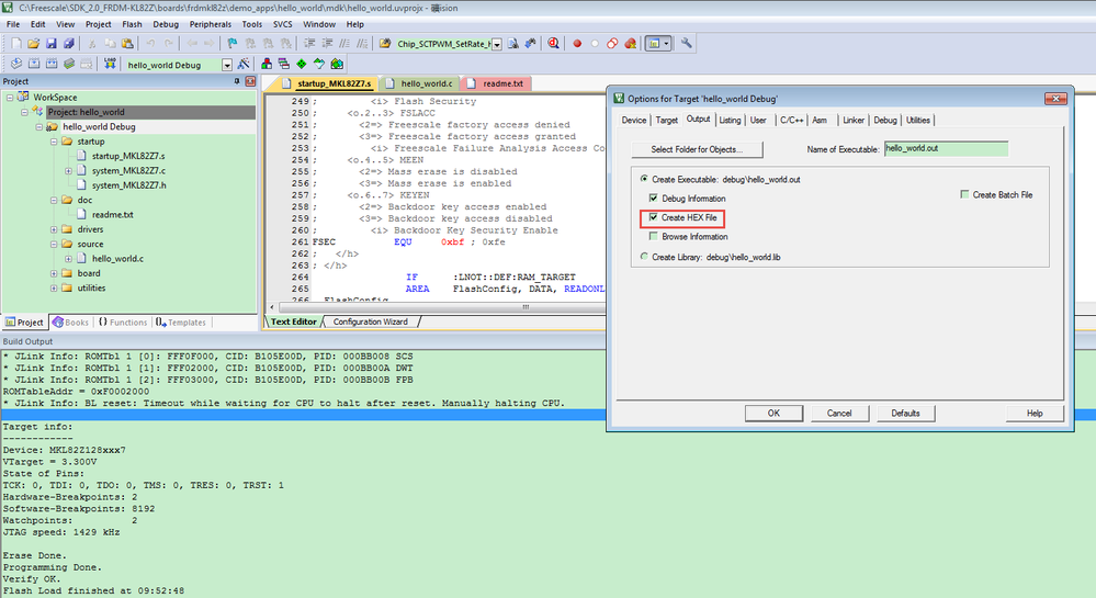

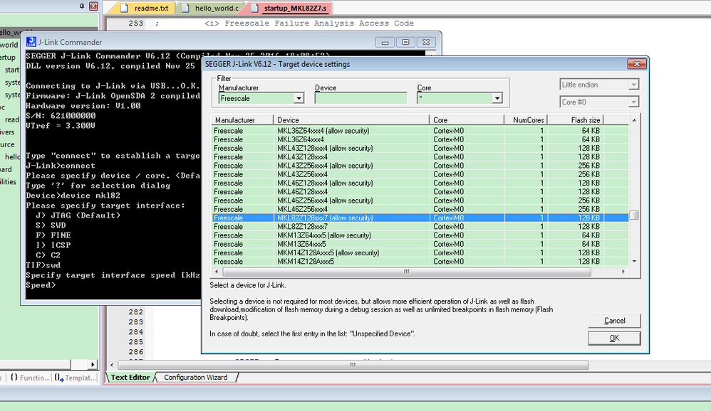

rysardsuboc
Hi Kerry,
when I modify FSEC register in Flash configuration in .s file, I set
security status secure (shown in first figure). In generated hex file, in
0x40C address I have 0xBF value (what I need).
But, when I download my code to flash, secure not changed. I checked it by
JLink with specific command (shown in second figure).
Why not saved security settings ?

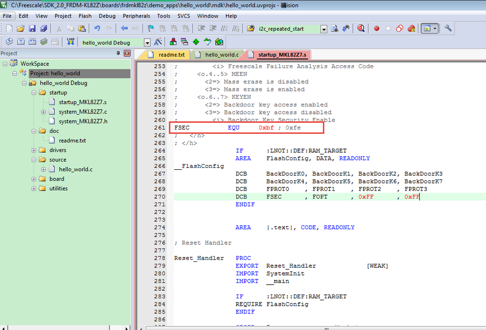

kerryzhou
Hi Rysard Suboc,
     I have test the FSEC byte modification in the KSDK2.0_FRDM-KL82 mdk project.
    1. modify 0X40C address data to 0XBF in the start file
2. Download the code to the board
3. use the JLINK Commander to check the data
You can find the 0X40C is 0XBF now.
You also can check it in our official ksdk2.0 sample code.
Wish it helps you!
If you still have question, please let me know!
Kerry

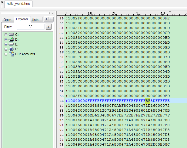

rysardsuboc
Hi Kerry and Jonathan,
I was away a few days.
I tried update segger JLink and upload bootloader to the board. In my
generated hex file I got 0xBF, but when I checked it with JLink.exe and I
got 0xBE.
And MDK not upload code to the board, because I get message that contents
mismatch at 0x40C (Flash=BEH Required=BF).
My MDK version: MDK-ARM Plus Version: 5.21a.

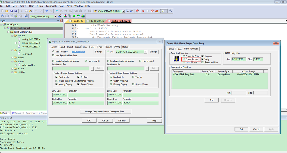

kerryzhou
Hi Rysard Suboc,
    You just add the project, no source file.
    But it doesn't matter, because you hex file is correct, I think it should caused by the download configuration in the IDE.
   Please check the following picture:
Choose erase sectors instead of erase full chip.
Please try it again on your side.
Wish it helps you!
Any test result, please let me know!
Kerry

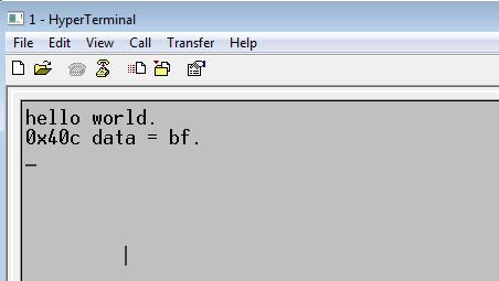

kerryzhou
Hi Rysard Suboc,
  Another way to check your flash address 0x40c, you can add the printf 0x40c code in your helloworld like this:
int main(void)
    char ch;
    /* Init board hardware. */
    BOARD_InitPins();
    BOARD_BootClockRUN();
    BOARD_InitDebugConsole();
    PRINTF("hello world.\r\n");
   PRINTF("0x40c data = %x.\r\n", *(uint8_t *)(0x40c));
    while (1)
        ch = GETCHAR();
        PUTCHAR(ch);
Then you will get the uart data in the PC after reset:
You can find the 0X40C data is 0xbf.
After the chip is secured, the SWD port cannot access the memory resources of the MCU.
So, after power off the board, then power on the board again, and connect with the jlink command,  I think the JLINK demand can't acces the memory, so it do the mass erase function automatically.
Wish it helps you!
Kerry

First: change FSEC value in startup file.
Second: In debugger settings choose "erase sections" not "erase full chip".
Third: If not working, change device name in JLinkSettings.ini file
to "MKL82Z128XXX7 (ALLOW SECURITY)".
