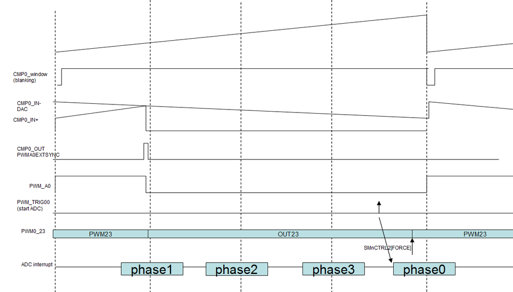

I was thinking of triggering my ADC sample near the end of the period (this helps with phase erosion) so my ADC interrupt would occur near the end of my period. FORCE_SEL would set to EXT_SYNC from the comparator output, then in my ADC interrupt I would
  • set SEL23 to PWM23
  • use SMnCTRL2[FORCE] to latch in PWM23
  • set SEL23 to OUT23
Would this work? or do I need to mess around with FORCE_SEL?

I have 4 eFlexPWM submodules, so generating 4 PWMs is sorted. To make these out of phase I will have to adjust VAL2/3 to turn on/off at the correct time, eg
  • PWM0_VAL2/3 -> 0=on  0+max duty=off
  • PWM1_VAL2/3 -> 0+1/4 period = on,  0+1/4 period+max duty = off
  • PWM2_VAL2/3 -> 0+2/4 period = on,  0+2/4 period+max duty = off
  • PWM3_VAL2/3 -> 0+3/4 period = on,  0+3/4 period+max duty = off
On each ADC interrupt I would set the ADC trigger to be generated in the next 1/4 period and change the ADC inputs to sample my next buck Vout and to reset PWM23 from OUT23 on each submodule.. I'm happy with this.
I don't know how I can generate the 4 out of phase blanking windows ;-(

Frankly speaking, I am not very clear about your idea. If you can draw a diagram which displays the required timing and ADC triggering point, it is fine.
Anyyway, it is okay to set the FORCE_SEL bits in PWMA_SMnCTRL2 as 3b'000(The local force signal, CTRL2[FORCE], from this submodule is used to force updates.), you can set the FORCE bit by software to switch the PWMx_A source anywhere.

My plan was to only use PWMA0_Trigger0 to trigger the ADC, and on every interrupt adjust PWMA0_Trigger0 by ¼ period as shown below. Your way saves me a couple of instructions.
But my problems are still the same.
1) How can I generate 4 blanking windows (CMP1/2/3/4_win) for the comparators.
2) How can I add a slope to the DAC1/2/3/4 output for slope compensation.
