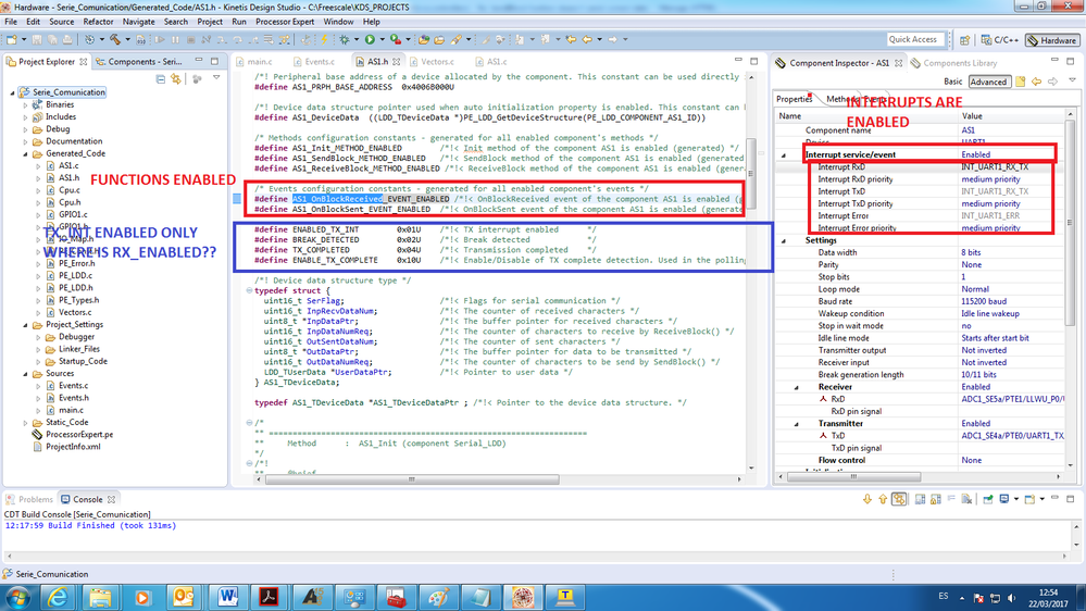

I have just managed to send a message to PC from a MK20DX256VLH7 microcontroller after changing the proposed configuration in “Getting started Guide for Processor Expert”.
Now I want to receive data from PC to microcontroller and to re-send from microcontroller to PC the same data. I have developed a new Project for testing to inizialite a future new application. The problem is that my project doesn´t receive anything now.

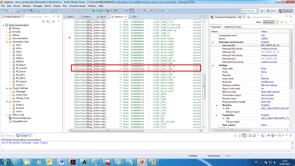

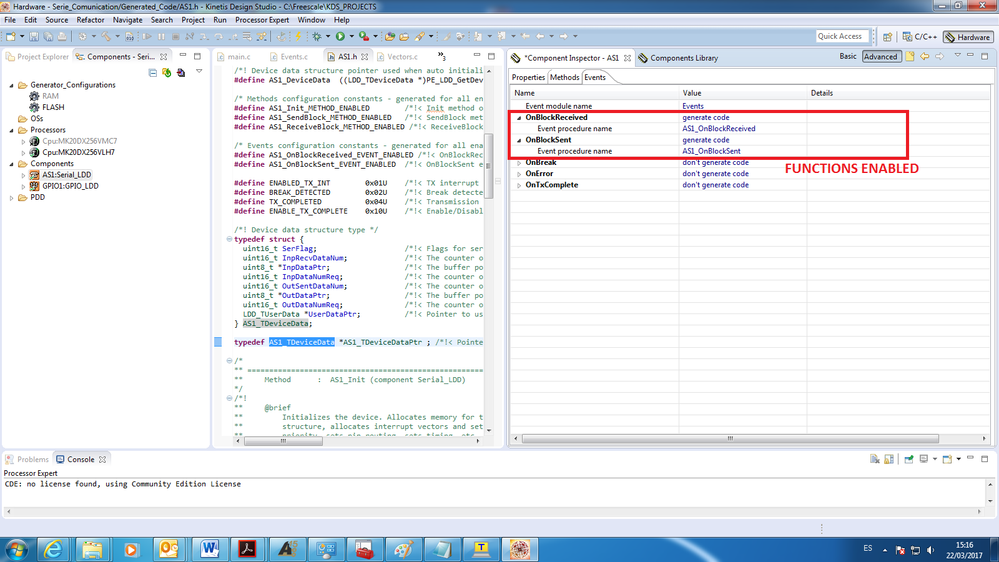

I have attached my proyect in this mail (Serie_Comunication) in which I use “AS1_OnBlockReceived” function in "Events.c" file. I think “AS1_OnBlockReceived” function should be called in "Events.c" file when a data is received but this function isn´t called when I send data from PC to microcontroller by writing from a keyboard in Tera application in order to send data to microcontroller. In this “AS1_OnBlockReceived” function I use “SendBlock” function (it´s just functional) and also I use “GPIO1_ToggleFieldBits” (this function makes a toggle in a led) in order to check if the function is really called “AS1_OnBlockReceived” function.
Why “AS1_OnBlockReceived”  function isn´t called when a data is sent for me from the PC to microcontroller?? This function is enabled in AS1 component and also it appears as enabled in “AS1.h” file from the project. Also you can see “PE_ISR(AS1_Interrupt)” function in “AS1.c” file. In “Vectors.c” file, you can see that both of the interrupts also appears.
Please, see all captured images attach here related on I have just mentioned before.
Should I configure anything more in the AS1 component ?? I can just send, but perhaps should be there any lack to manage the reception data and send data at the same time??
I have seen in “AS1.h” file that “TX interrupt” is enabled. In 146 line from “AS1.h” file, you can see the next:
#define ENABLED_TX_INT        0x01U    /*!< TX interrupt enabled      */
#define BREAK_DETECTED        0x02U    /*!< Break detected            */
#define TX_COMPLETED          0x04U    /*!< Transmission completed    */
#define ENABLE_TX_COMPLETE    0x10U    /*!< Enable/Disable of TX complete detection. Used in the polling mode only */
but I haven’t found anything about RX interrupt enabled. Do you know anyway in the configuration that you can set "RX interrupt" enabled like “TX interrupt”?

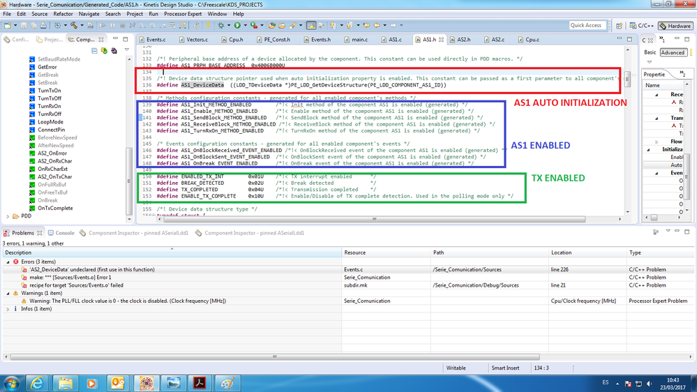

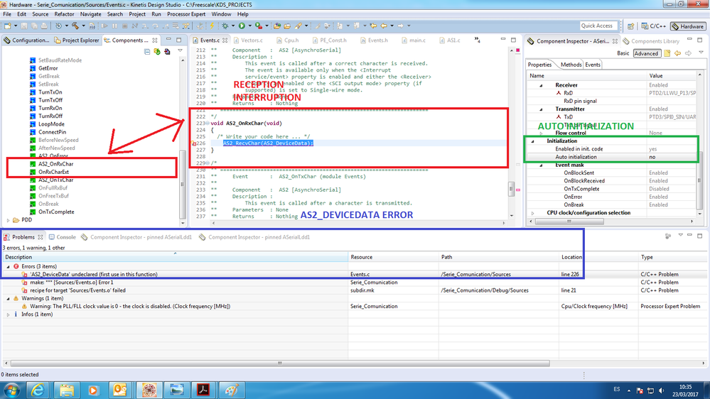

I´ve been researching in Processor Expert and I've found another component called "Asynchro Serial" component. In this component I´ve seen another methods in order to receive not only with blocks, also it exists funtions that transmit chars. You can see the component in this image.
But I´ve found another problem with this component, I can´t initialize the component because the "Auto initialization" setting is disabled, and it appears written "NO" by default in this setting. I'be been looking how to enable this "Auto initialization" setting, but I haven't found anything. Without initializing doesn't recognize "Asynchro Serial" component, and when I build the Project, I have errors of compilation. You can see the components and errors of compilation because of not setting "Auto Initialization". It appears "disabled".
For the another component "Serial_LDD" in "AS1.h" file, appears that "AS1_DeviceData" is used only when the auto initialization is enabled. You can see in this file where "AS1_DeviceData" is created. I doesn' t appear anything about "AS1_DeviceData"  component.
How can I get "Auto Initialization" enable for "AS2_DeviceData" component? Do you know? I´ve looking at Preferences how can enable this setting, but I haven't found anything?
