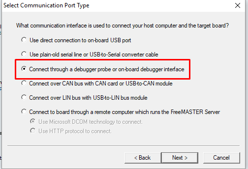

When i open the .pmp program that opens Freemaster and then i press the GO! icon a window appears telling me that the DEVKIT-ZVL128 is not connected then i press the Use Wizard so i can configure the connection, i choose the
Use direct connection to on-board USB port then when choosing baud rate i choose 9600 and 115200 so it can connect but another windows appears saying No board detected on any specified UART communication ports even though i have the board connected and it appears on the Probing UART Ports.pastedImage_7.jpg

I assume that your board is connected through the OSBDM or BDM interface.
Please follow the steps below:
1. Go to menu Tools -> Connection Wizard -> Next
2. Choose the "Connect through a debugger probe or on-board debugger interface" -> Next -> Next
3. Click on the Plug-in Configuration
4. Select " P&E OSBDM" or "P&E HCS12Z" (it depends which interface you use), after that you can Test Connection -> Ok -> Ok -> Finish
After that, it should be connected.
I hope it helps.

Thanks a lot, it works with the P&E HCS12Z configuration but i seem to run into another problem, because I'm using the devkit-zvl128 connected to a TouchPAD i want to measure the touch with freemaster, the problem is that freemaster can't detect the touch even tought the program I'm using turns on a LED when i touch one of the electrodes of the PAD and the freemaster program has the electrodes variables so the measure should appear but  it doesn't. What can i do.
2,449 Views
efrain_castro
Forget it i used a P&E micro multilink universal for  the measure thanks you because the configuration is the same.
