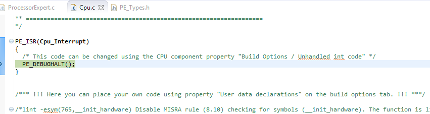

I forgot to mention this to you,when debugging i observed some odd things :
The code hangs at this particular ISR.
After a little digging , found out that this was linked to the RTC settings.
So when i disabled the RTC Oscillator.So i disabled the RTC module from PE,the code moved forward,but again hit a snag.

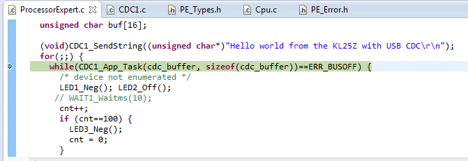

Next ,whe i ran the debugger ,it hanged at
digging further into CDC1_App_Task(),i found that it was returning the ERR_BUSOFF (as you can see from above)

BlackNight
The ERR_BUSOFF means that the device has not been enumerated by the host.
Either you have no USB cable connected, or the drivers are not installed/running on the host.
Erich
