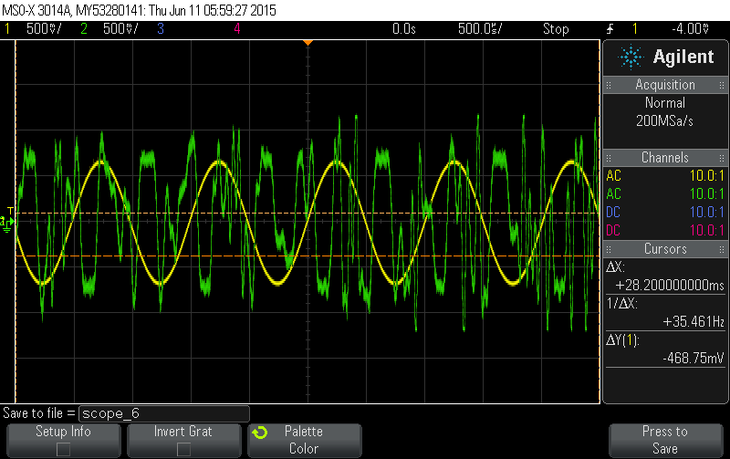

Hello Kinetis users,
I am fairly new to Kinetis and brand new to CMSIS-DSP.  I am trying to use the CMSIS-DSP arm_fir_q31 library function to filter an audio signal.  When I try to use the arm_fir_q31 function I get an output signal with a lot of noise as shown below.  When I remove the arm_fir_q31 function and just do a pass through, the signal looks ok.  It also looks ok when I use the arm_negate_q31 function and I do see the negation.
Noisy output with arm_fir_q31 enabled.  (Yellow=input, Green=output)

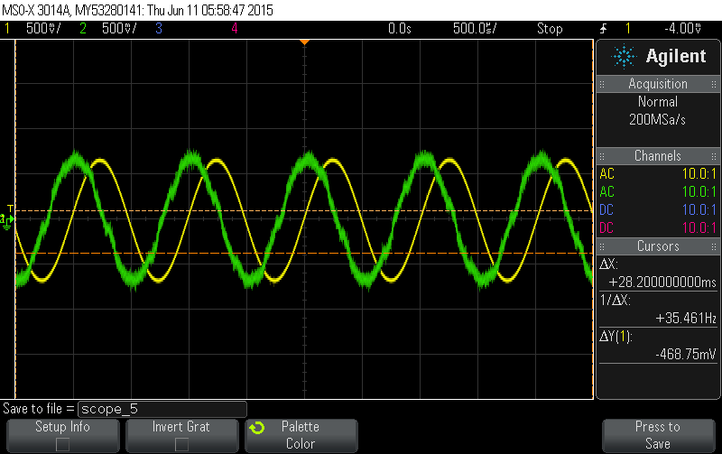

ok output signal with arm_fir_q31 disabled.  (Yellow=input, Green=output)
Here are the details of my system:
  • Kinetis K70 MCU in tower system
  • Custom tower module with TI TLV320AIC3007 CODEC, configured as I2S slave, 48kHz sample rate, 24bit samples packed in 32 bit words
  • I2S communication between Codec and K70.
  • DMA handles data transfer in "ping-pong" buffering scheme.  512 samples per block, stereo audio data.
The things I am unsure about are the conversion from raw ADC samples received over I2S (24 bit unsigned ADC value packed in 32 bit unsigned int) to Q31 format and the conversion back from Q31 to unsigned 24 bit value packed in 32 bit unsigned int after processing through arm_fir_q31 function.
My questions are:
  1. Is my method correct for converting the raw ADC samples received from the codec to Q31 format? (lines 08 - 17)
  2. Is my method correct for converting from Q31 format back to a 24 bit unsigned value? (lines 26 - 35)
  3. Do you see where I am going wrong?
Function called when I2S Rx buffer is filled.  It converts raw samples to Q31, calls arm_fir_q31 function to process data block, converts back to 24 bit unsigned samples, and loads in I2S Tx buffer.

"if(RxDMABuffer[i][bufIndx].samples[j] & 0x0080000){ //bit 23 is set"
Are you checking 20th bit instead of 24th bit!

Thanks for catching that error, Nehal.  It turned out, in addition to this error, I also had my codec configured incorrectly.  The bit alignment was off, causing the sign bit to be shifted by one.  Thish caused the random seeming noise and roll over observed when I applied the fir filter.  After correcting the error you found and correcting the codec configuration all is working.  Thank you.
