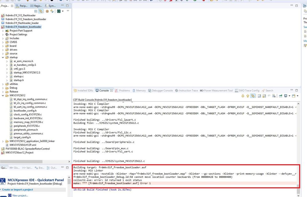

I'm newbie in 31f chip, I want to build freedom bootloader for MKV31f256. I have use sample from https://www.nxp.com/support/developer-resources/software-development-tools/mcuxpresso-software-and-t... (Bootloader 2.0) and make some change for my MKV31F chip. But when compile it's fail. Anyone can help me to create and build this boot loader.

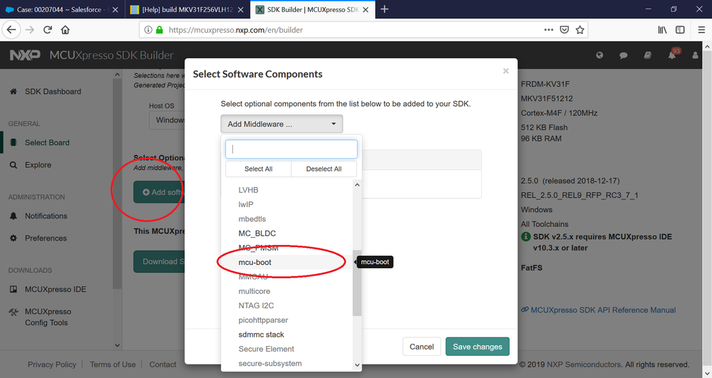

jingpan
You should add this component when make your own sdk. Please see the screenshot.
6,938 Views

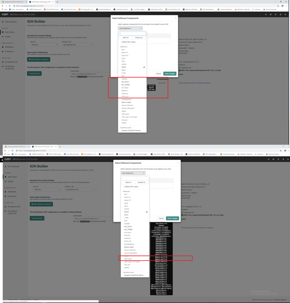

nguyenhoainam24
Thanks a lot. But I can not select MCU boot. it's require USB stack and my MKV31F is not available.
6,938 Views
jingpan
Please select MKV31F512 or FRDM-KV31F. They have mcu-boot.

nguyenhoainam24
Almost done, but I have error when change from KV31f512 to KV31f256. It's may be not enough memory or something like this.
6,938 Views
jingpan
There is no need to change mkv31f512 to mkv31f256. Because they are only different in flash size.
Did you replace MKV31Fxxx_feature.h and MKV31Fxxx12.h?
6,938 Views
nguyenhoainam24
yes, i did. I have change all file in folder MKV31F25612
6,938 Views
jingpan
There are some defined symbol need to be change in properties->C/C++build->Settings->preprocessor, like CPU_MKV31F512VLL12. Didi you modify them?
Or can you send me your project?
