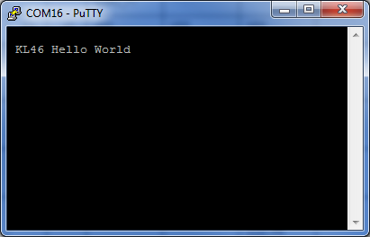

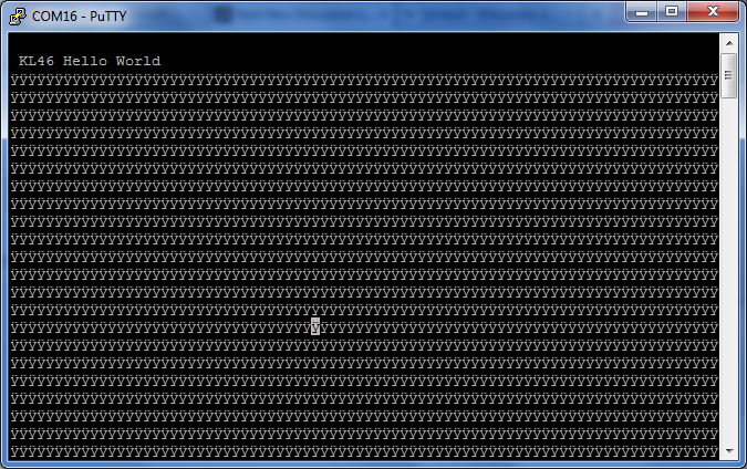

Hello all,
The hello world example source code is printing strange characters on the terminal. I get the "KL46 Hello World" message on the terminal followed by a continuous stream of "ÿ" (a letter "y" with an umlaut - the two dots on top). I can only get the stream of "ÿ" characters to stop by stopping the debugging session within CodeWarrior.
The first time I imported the project I got it to work correctly. I configured the terminal (I'm using PuTTY) according to the accompanying "FRDM-KL46Z_CW_rev1" PDF and I got the hello world message and I could see that any character I typed was echoed to the terminal followed by a character return/new line feed.
Today I opened up the project again and I get the described error. Strangely, I have made no changes to the code, or project settings (at least not that I was aware of). What's even stranger is that I have deleted all the examples and then re-installed them and I still get the same error. I re-installed the examples by running the KL46_SC.exe file that one can download from the freescale.com/frdm-kl46z website. One would think that by re-installing the files one would eliminate the possibility of having changed the code or settings on the previous install.

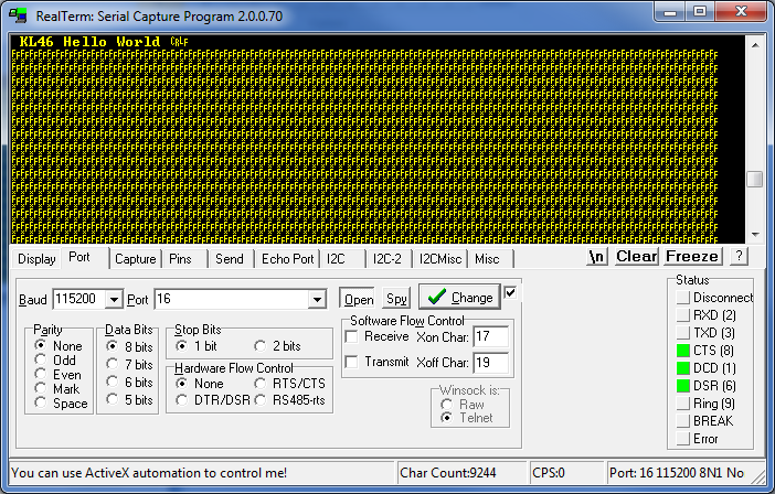

Hello Nasreen,
Thank you for your suggestion. I tried using RealTerm v2.0.0.70 (another terminal app) and I still have the same problem. I get an endless stream of "ÿ" characters. I downloaded the P&E Micro Embedded Multilink Toolkit but it gives me an error when I try to install it. So I haven't been able to try P&E Micro's terminal app. (I have already reported this installation error to P&E Micro).
Getting the same problem using two different terminal apps leads me to believe the problem is either with the board, the project settings or CodeWarrior/Eclipse. As I said before, I deleted the example project's files and re-installed them again and I still have the problem. I was able to get the code to work the first time I opened the project. Maybe some setting in CW/Eclipse is messed up? The attached images are proof that I got the code to run once and they show the current problem. Realterm shows a character that looks like an "F". When I copy and paste somewhere else it comes out as a "ÿ".

So I tried:
  • Adding a second printf statement below the Hello World message.
    • That worked but I still had the endless stream of "ÿ" characters.
  • Then I tried commenting out the for loop that receives and echoes user input to the terminal.
    • That also worked and I no longer experienced the endless stream of characters.
Therefore either:
  • a) My terminal apps (PuTTY and Realterm) are configured the wrong way.
    • This could be, but I doubt it since I've seen the code work once using PuTTY and the Freescale guide only asks for 8 data bits, 1 stop bit, no parity, no flow control and 115200 baud. That's simple and I've triple checked the configuration on both terminal apps.
  • b) There's a problem with the Freescale or ARM GNU libraries regarding either collecting user input or echoing it back to the terminal.
    • I tried executing the code from the for loop only once. This consists of the statements:
      • InpData[0] = getchar();
        printf("%c",InpData[0]);
    • The result was that the "ÿ" character was printed once to the terminal.
      • I tried using my own character variable "TestChar" instead of an array of character type.
        • I still got the "ÿ" character printed once.
Switching my terminal to binary instead of ASCII output reveals that the "ÿ" character is hex value 0xFF. So this could also mean that the KL46's UART thinks that it is receiving a 0xFF character when in reality the Rx line has stayed at logic high. This could explain why with the for loop I get an endless stream of 0xFF characters. The UART interface is thinking that a constant logic high on Rx means an infinite stream of 0xFF characters.
But why?
Any suggestions would be appreciated. Also if any of you have a basic working UART Hello World example for the FRDM-KL46 I would be happy to take a look at it.

If you are reading this far down you must have the same issue of getting the y with the two dots. The cause is that GETCHAR is defined as DbgConsole_Getchar and every time it runs it will return  a -1 or 0xff which is the y with two dots. I'm not sure if this is the correct fix but it worked for me. I changed this:
#define SDK_DEBUGCONSOLE 1U
to this:
#define SDK_DEBUGCONSOLE 0U
Which caused GETCHAR to be defined as getchar. And it worked! Hope this helps!
