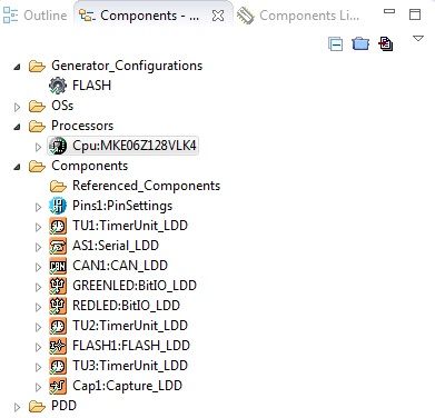

So I've setup my own development environment using Eclipse CDT, the GNU Toolchain, Processor Expert Drivers, and the Eclipse Processor Expert Plugin.
I unfortunately do not see the option for I/O support when creating a project, and the "Librarian" option isn't available due to the GNU Toolchain being used instead of the Code Warrior one. I've attached an image of the includes that I am using:
I don't see a component that would be related to the console either:

Hi stefan,
In KDS-PE project,  please select "Console" component here :
And if about the FRDM-KE06Z board , please configure like this :

I attempted to try Alice's suggestion out, but I had trouble switching my prior usage of UART1 to UART0 so that I could then have the ConsoleIO use UART1 instead. In the near future I will give this another try.
Out of curiosity Alice, why would adding the ConsoleIO address the issue?
