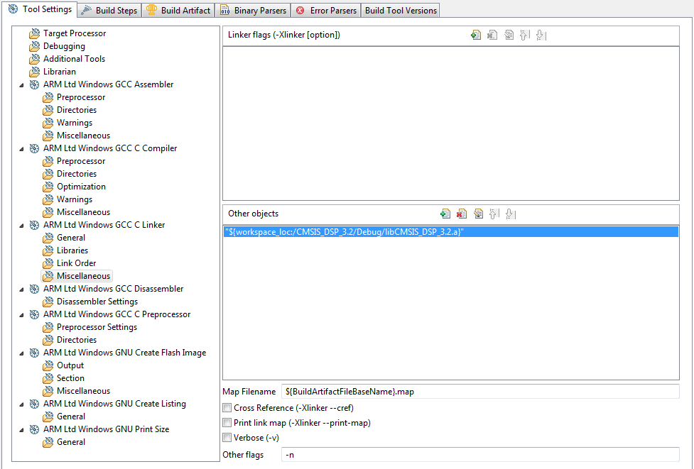

martynhunt

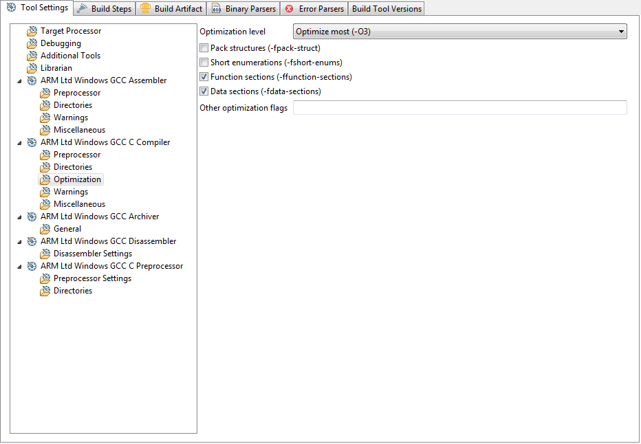

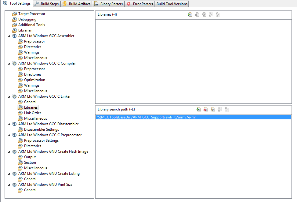

I have some good news. Your build of the library has the correct compiler options set, and your applications does as well. However, it appears you are linking the application to the pre-built library provided by CMSIS. This pre-built version does not have -ffunction-sections -fdata-sections set; therefore, the unused data will not be removed.
To link your rebuild of the library correctly into your project you need to make sure you have the following properties set:
and:
Please let me know if this works for you.
Martyn
P.S. For reference the correct compiler settings for library and application are:
Library Compiler:
Application compiler and linker options:

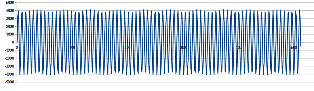

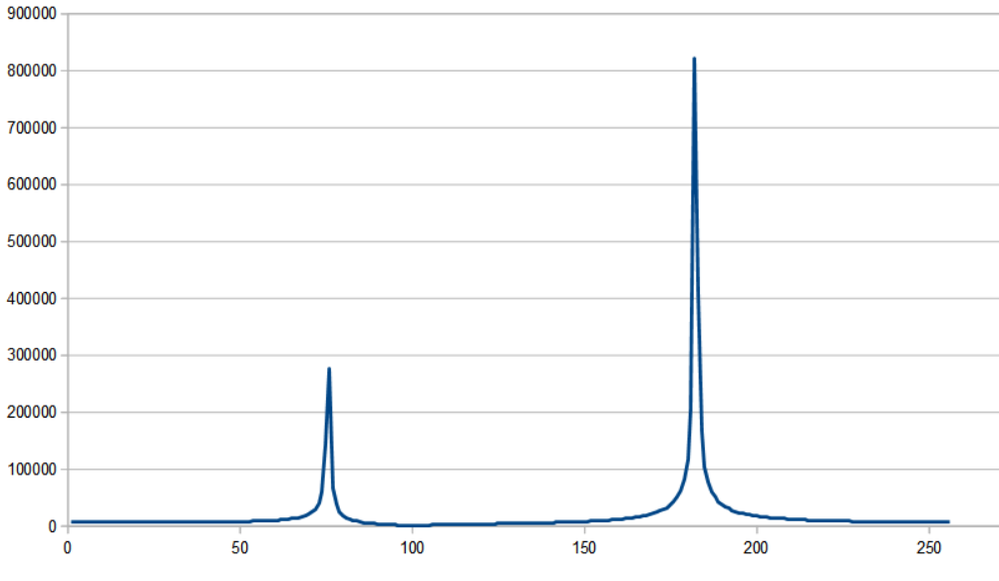

I am hoping to find some people who have used this with floating points and could maybe explain why I get these results?
Test code:
float fft_input_buffer[512];
float fft_magnitude_buffer[256];
fnInjectFloat(fft_input_buffer, 512);
arm_cfft_f32(&arm_cfft_sR_f32_len256, fft_input_buffer, 0, 1); // perform complex fast-fourier transform (the result is in the input buffer)
arm_cmplx_mag_f32(fft_input_buffer, fft_magnitude_buffer, 256); // calculate the magnitude of each frequency component (256 bins are now available) - 48kHz sampling rate gives 0..24kHz spectrum with 93Hz resolution per bin
The function fnInjectFloat() is putting a high resolution test signal, in this specific reference case a 7'000Hz sine wave, into the input buffer.
Before calling the FFT the input buffer can be displayed to have the expected input signal (75 cycles in 512 input buffer):
After performing the FFT and calculating the magnitude of the output bins one expects to find the energy at 7kHz. This is however the result in the magnitude buffer:
There is a nice peak at 7kHz but there is a second peak at 17kHz (24kHz - 7kHz) with three times the energy.
I have tested with various FFT lengths with the same result.
I have tested on various chips (m0+, m4 - with and without FPU) and in each case with the same result.
If the test frequency is increase, eg. to 8kHz the second component is at 16kHz (24kHz - 8 kHz). If a frequency greater than 12kHz is injected the unexpected bin energy is less that 12kHz.
Finally, if real sampled input is used - rather than preparing a signal in the input buffer - the same results are also obtained in each case.
I can't believe that the CMSIS FFT doesn't work (I tried version 3.2 and also the very latest V5.1) but the results are presently not usable.... The only code used is the CMSIS library code so I presently see no influences that can cause errors to be introduced.
Can anyone verify or explain what is happening?

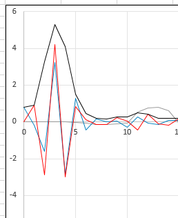

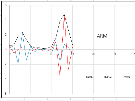

Hi All
Here are a further simple comparison result.
Another example where we have taken a simple 16 point FFT with a windowed signal (32 samples of a simple test single).
The same 32 input samples into the same FFT in Matlab gives:
There are certain similarities and their is a feeling that something is inverted but no attempts to work out what needs to be moved around has been successful yet!
The present situation is than no one here (several engineers with DSP/signal processing experience) have any idea what is going on to give such results....

Earl
I have realised that the CMSIS CFFT requires that the inputs samples are complex. If I insert a 0 between each sample (representing a zero complex valid) I then get correct results. The ARM reference also has 0.0 at every second array location in its input, which is why it works.
There is also a RFFT version (real) which I was hoping would save having to put in the zeros but initial tests didn't confirm this. For the moment I am continuing with the CFFT and might retry the RFFT later again (it may be faster since it performs a CFFT of half the size and then extracts real value from it [somehow]).
Since I wasn't getting an responses here or at mbed I tried "DSPrelated" and quickly got some ideas that led to the resolution.

It is not single-instruction. It is a function that reverses bit order of all elements of FFT output array after calling FFT over an array. The function is member of ARM CMSIS Math (DSP) Library.
20,713 Views
martynhunt
Here is the FFT bin example from an older version of CMSIS-DSP. Hopefully this helps you. It is for f32, but should work if you change the names to q15 versions.
Martyn
