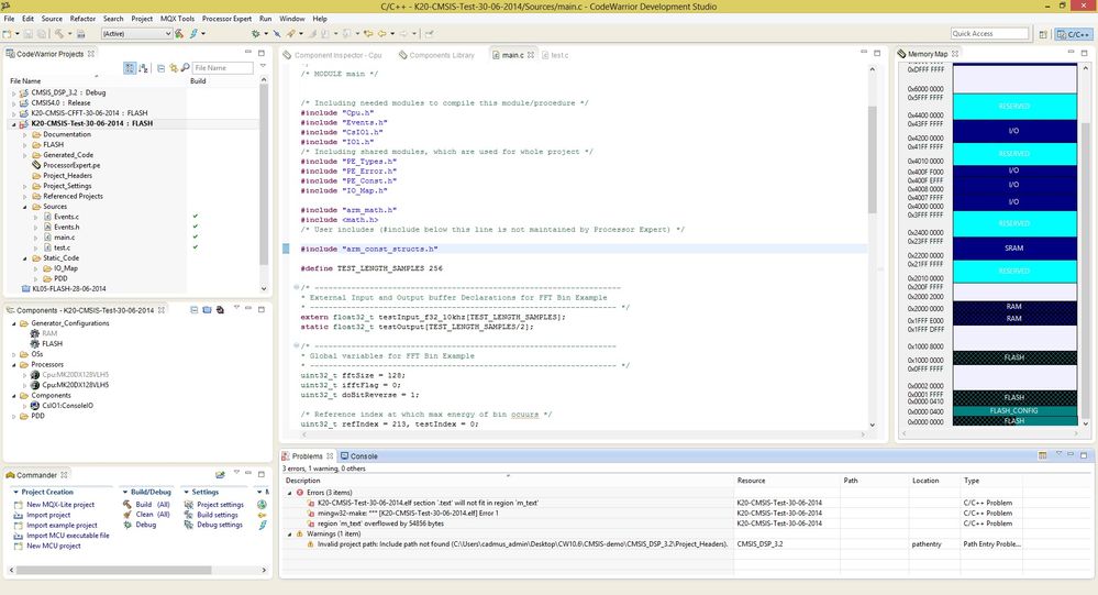

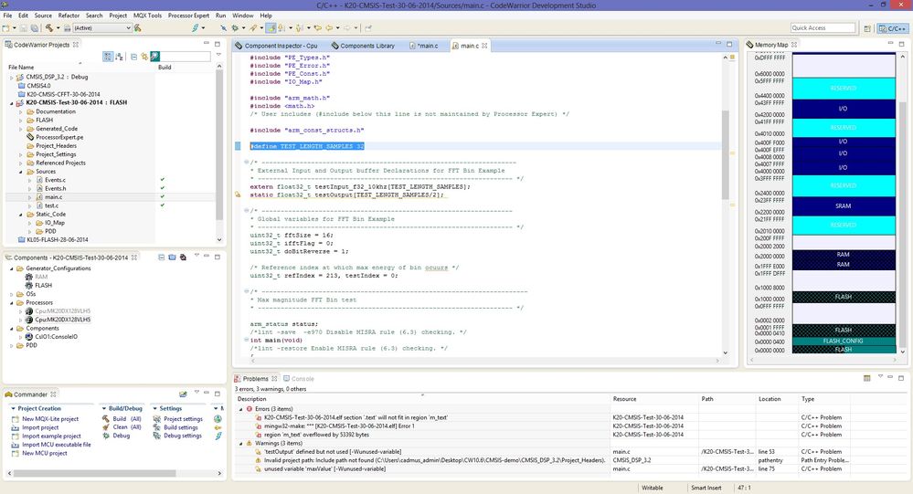

I Tried implementing the CFFT code into my project. It gave an error that m_text overflowed. Then I configured the flex mem and increased the size but still the error was the same and the amount by which it was being overflowed was the same, then I reduced the input buffer size from 2048 to 32 but still the same message. I tested the library by implementing sine, cosine function example code and that is working fine then I tried to implement CFFT example code which still didn't worked. Currently I am using CMSIS 3.2, with codewarrior10.6 and I am implementing this on FRDM-K20D50M board. Attached is my project with built library please have a look into it.
The error snapshot when the data array was 256.
Kind Regards
Amit Kumar
3,380 Views
BlackNight
m_text overflowed means that your application is too big, and according to the screenshot it is over by more than 50 KByte.
I have not checked your project, but it looks like your are linking too much?

Thanks for the reply. How do I overcome this error? any suggestions? I checked with reduced array size from 2048 to 32. but the size by which it is overflowing is the same. there is a warning message also which says invalid project path. Is that message of any concern?
