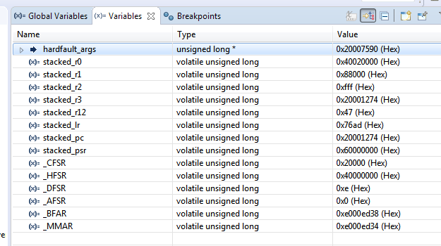

...i've managed to at least see what instruction is causing the hard fault.  What I could use now is some help deciphering the status registers captured in the hard fault handler.
When the hard fault breakpoint hits, this the state everything is in...

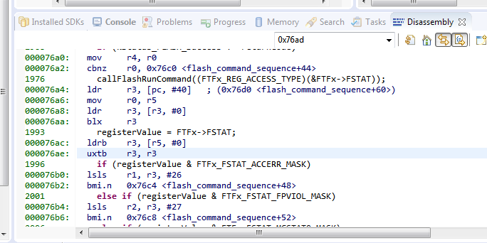

From here, I used stacked_lr (0x76ad) to locate the instruction prior to the break...
At this point, i'm running under the assumption that the fault occurs when accessing the FTFE (FTFx = 0x40020000) register with callFlashRunCommand.

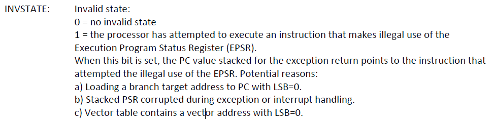

Looking at the values of the hard fault status registers and comparing to the register definitions found in the Keil appnote, I see that bit 17 of the _CFSR is set, which means an invalid state.  Specifically...

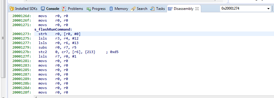

Based on this information, I find the PC contains 0x20001274.  Looking at this location, I find the following...
From this, I'm assuming the issue is the first instruction of s_flashRunCommand.

It seems very strange in your screenshot that s_flashRunCommand is locate at odd address (0x20001273). This is why you always see hardfault. ARM operation code must halfworld aligned. In NXP's driver,   s_flashRunCommand is defined as
    static uint32_t s_ftfxRunCommand[kFTFx_RamFuncMaxSizeInWords];
It should not be allocate at odd address.

It is normal to have the RAM code at an odd address - this is Thumb2 alignment and an even address would fail.

Yes, disable all interrupt is a good advise. But you say that Thumb2 alignment is odd... Are you sure?
An odd data (address+1) must be written to PC when jumping. But code must even alignment.

I made a mistake and you are correct. The code must be aligned on short word boundaries and called with its address + 1, as you have stated (ad not the other way around as I incorrectly wrote).
Therefore you are probably right that the source of difficulty is that the RAM buffer used for the flashing code is not guaranteed to be aligned and so sometimes works and sometimes fails (depending on other variables and how it happens to fall).

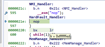

Mark, I tried your suggestion of just setting a breakpoint inside the default Hardfault_Handler.
From what I can tell, it appears to be failing at the following line...
where r3=0x20001274 and r4 = 0x0.
You asked about r0 in the line previous.  The value of r0 is 0x40020000.

Stepping out of the hard fault is showing your about the same location that you had concluded before (maybe one line further (?)). What normally happens is that you land back at the line that faulted and when you step again it makes exactly the same error and jumps back to the hard fault.
This also gives you the possibility of moving the program counter to move to the previous or next line to see whether the next instruction is OK, change register values to work out which one is bad, etc. (essentially much easier and more flexible than the various hard fault call stack debugging guides etc. - although it does need a debugger attached of course)
I don't see any risk in either of the two instructions so I do think that you have an alignment problem and the processor is not executing the instructs that you see and therefore is failing for a more random reason. I have copied the way that the flashing routine is located in SRAM in the uTasker project - note that the code buffer is constructed of unsigned shorts (thumb2 instruction length and alignment boundary) and so is naturally always correctly aligned. If your buffer is an unsigned char buffer there is a risk and it will be hard to control its alignments.
