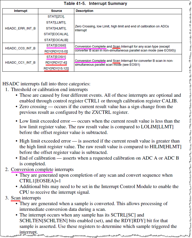

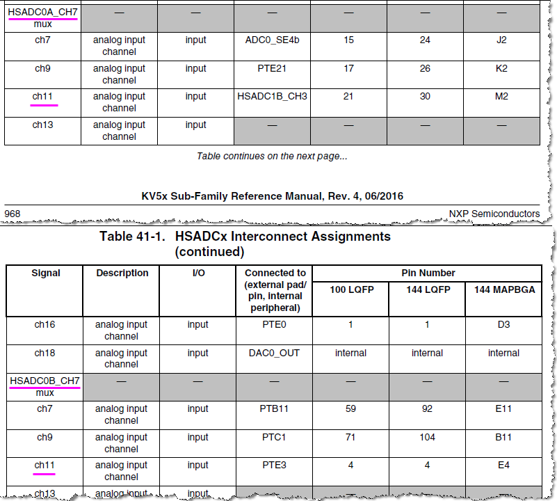

Would you please tell me which channel are you using? HSADC0A or HSADC0B
If you connect external signal to PTE3, then you may need to :
void HSADC0_CCB_IRQHandler(void)
    HSADC_ClearStatusFlags(DEMO_HSADC_BASEADDR, kHSADC_ConverterBEndOfScanFlag);
EnableIRQ(HSADC0_CCB_IRQn);
HSADC_EnableInterrupts(DEMO_HSADC_BASEADDR, kHSADC_ConverterBEndOfScanInterruptEnable);
The Conversion complete interrupts and Scan interrupts are different. Please read "41.6 Interrupts" in KV5XP144M240RM.
HSADC_EnableInterrupts can be used to enable Conversion complete interrupts.
HSADC_EnableSampleResultReadyInterrupts is used to enable Scan interrupts.
Robin
1,797 次查看
a8Chcx
Contributor V
Hi Robin,
I connect as follows:
HSADC0A ch0-->Pin18
HSADC0A ch1-->Pin19
HSADC0A ch2-->Pin27
HSADC0A ch3-->Pin28
HSADC0A ch4-->Pin37
HSADC0A ch5-->Pin38
HSADC0A ch6-->Pin23
HSADC0A ch7-->Pin24
HSADC0B ch3-->Pin82
HSADC0B ch4-->Pin45
HSADC0B ch5-->Pin46
I am using the sequential scan.
If I enable "HSADC_EnableInterrupts(DEMO_HSADC_BASEADDR, SADC_ConverterAEndOfScanInterruptEnable);",
the interrupt will not be generated. But I can see there is the scan end status if I check the state register.
Only way to generate the interrupt is enable any sample interrupt by using " HSADC_EnableSampleResultReadyInterrupts(INETVU_HSADC0_BASEADDR, 0x0400, true);"
I do not know why the scan end interrupt does not work in this case?
