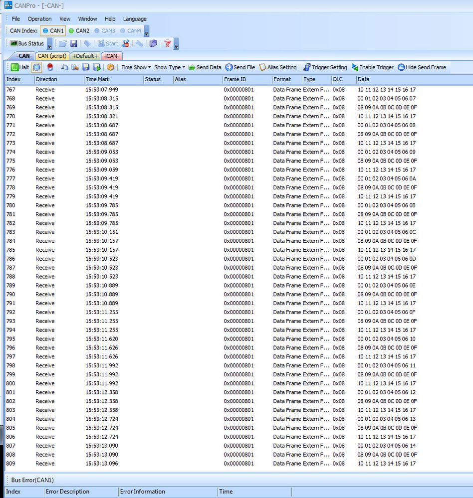

  Please check my project on your side, this project is also 250Kbps baudrate for MSCAN, it is working ok on my TRK-KEA128 board.
  I check it with the CAN test tool, and send data to PC, none TX error happens.
  This is the test result:
  The codewarrior project is in the attachment.
Wish it helps you!
If you still have problem, please let me know!
Jingjing

    I have check your CAN initialization, it is no problem for 250Khz baud rate, I test it on my side, it also have no problem.
    I think it may relate to your main function code, you can try add some delay between each transmit calling.
    I call it like this:
for(;;)
for(j=0;j<10;j++) for(i=0;i<65535;i++);
TEST_CASE_FUNC(Demo_Transmit_DataFrame);//set different parameter to choose other test case to run
  The CAN test tool can receive all the data.
