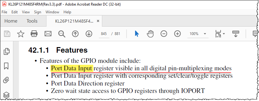

I need to generate 7 PWMs and, simultaneously, get the states from 4 of them to update some variables. Is there any direct way to do this directly from the FTM, instead of using additional GPIO pins to detect the changes in the PWMs?

Hi Elisa,
Port Data Input register visible in all digital pin-multiplexing modes, so please try to read the Port Data Input Register (GPIOx_PDIR).
Port Data Input register visible in all digital pin-multiplexing modes.pngPort Data Input register visible in all digital pin-multiplexing modes.png
