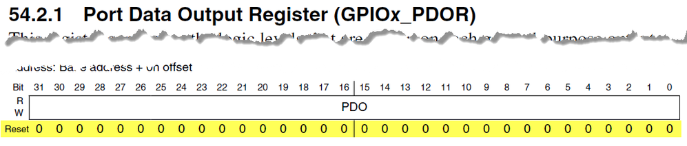

If you mean the value of the GPIO registers out of reset, then that information is in each register description, again in the reference manual. e.g. for the GPIOx_PDOR register:
None of the above behaviors can be changed.
