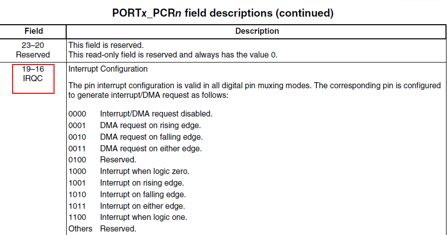

Hi Hui,
Have you config the IRQC:
and config the corresponding interrupt vector table ?
Hope it helps
