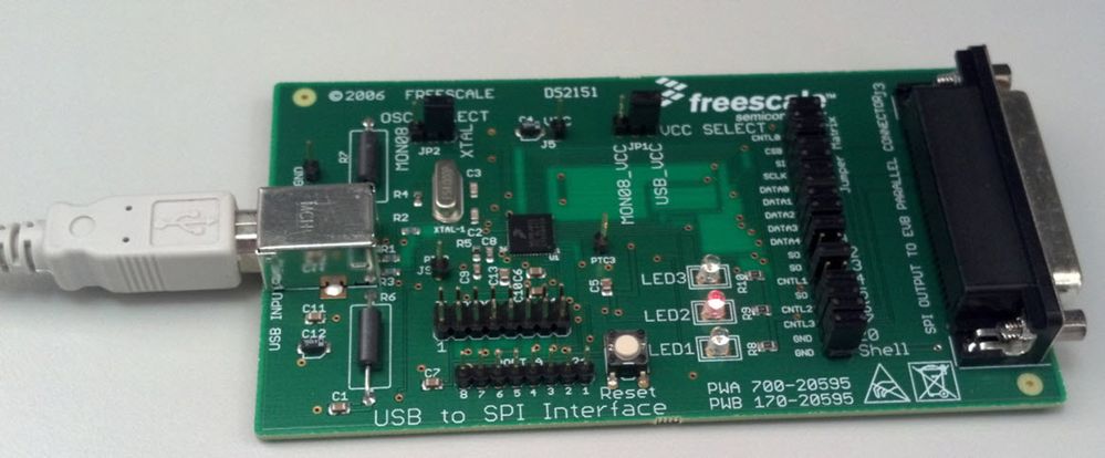

Please download [SPIGEN version 7.1.2 PC interface software for Windows 7, 8, XP and Vista] from below link:
SPI Generator (SPIGen) Software|Freescale
There also provides USB to SPI Device Driver Installation Instructions - User Guide  about how to install the SPIGen driver to Windows system.
It needs to use KITUSBSPIEVME board (Evaluation Kit - USB-SPI interface), more detailed info, please check below link:
Evaluation Kit - USB-SPI interface, MC68HC908|Freescale

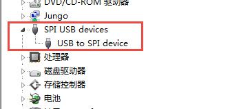

With KITUSBSPIEVME boards connects to USB cable, the [USB to SPI device] will be recognized as below:
Wish it helps.

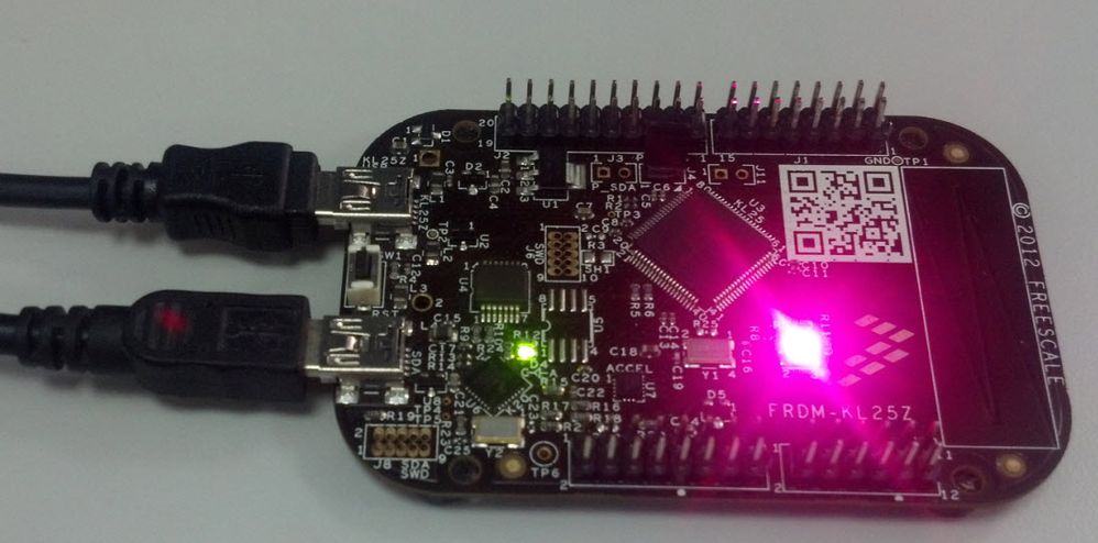

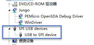

I have tried to use FRDM-KL25Z board as USB to SPI device and it works.
Please check my connection for FRDM-KL25Z board and Windows device info:
Please re-program FRDM-KL25Z board with [UsbSpiDongleKL25Zv504] image and check again if it works or not.

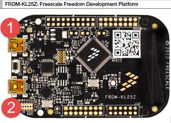

For you are using FRDM-KL25Z board, I want to know which USB port you connected to PC?
Port 1 is KL25 USB port;
Port 2 is on board OpenSDA debugger port.
Wish it helps.
best regards
