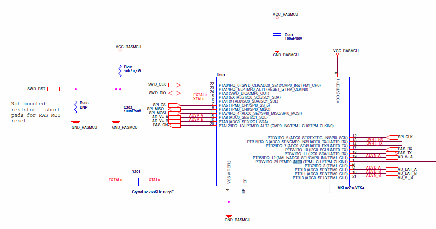

I'm having a super weird problem with two pin outputs in my application.
I'm using a Kinetis MKL02Z16VFK4 part and trying to put logical level 3.3V on PTB3 and PTB4. And here is the strange thing:
1. If I measure them with a multimeter, the measurement is ~3.76V (ON) and 0.0V (OFF)
2. If I measure them with a scope, there is almost no signal at all (it reaches something like 120mV during on state - which looks more like noise)

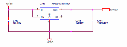

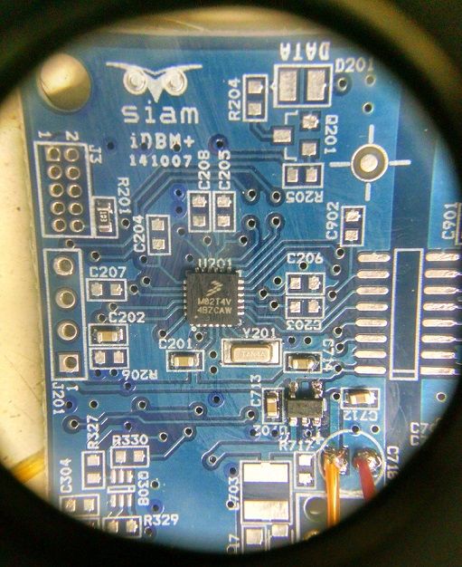

I've two boards with the same problem - and in order to isolate my problem I've mounted a third one leaving all pins open, using only the basic components, which are shown in figure below.
- I'm connecting a 12Vdc power supply directly on LDO input 12Viso (red and yellow wires on picture below).
- 3.3Viso net is connected to VCC_RASMCU net.
- I've soldered all capacitors and resistors (except R206, of course).
In the picture below the PCB area of interest is shown:

I assume that you know that these two ports are true open-drain.
If you are reading more than 3.3V with the multimeter the multimeter is probably supplying some current and causing a higher voltage to me measured. Your oscilloscope is probably very high impedent in comparison and so will measure almost no change.
Simply connect multimeter and oscilloscope "at the same time" to see the effect of the measurement instruments - remember that measurement instruments can effect the measurement being made so always consider this carefully.

No, Mark, I didn't know that! I've been searching for the wrong keywords in the reference manual - after you replied me I could find this information on it!
Things are working as expected now, thank you very much for your fast response!

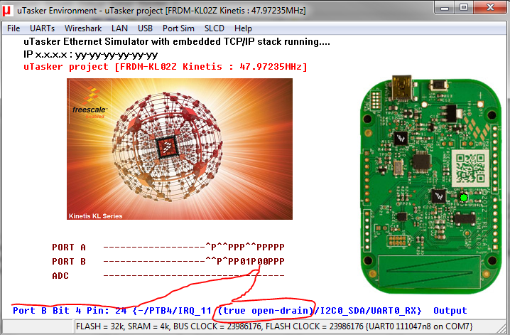

Using the uTasker project one sees such things without needing to search:
and can avoid lost development time ;-)
