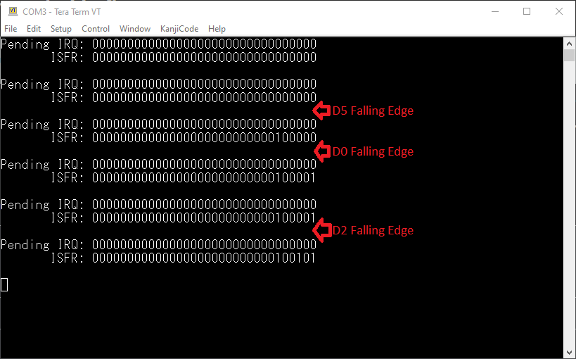

I'm trying to set up interrupts for pins 0,5, and 2 of Port D of my FRDM-KL25z. I want the interrupts to trigger on a falling edge. For testing purposes, I have written the ISR to turn on the Red LED, using code that wrote for a previous project (LED.c). Below is my main code file.
I've tried to execute the following steps to set up interrupts:
  1. Use the NVIC_EnableIRQ function to enable interrupts from Port D
  2. Configure pins 0,2,5 as GPIO inputs and to request interrupts on the falling edge
  3. Write the PORTD_IRQHandler function to do something (in this case, turn on the red LED).
Unfortunately, the red LED is not turning on when I transition any of the pins from logical 1 to 0. I've confirmed that the pins are functioning as inputs through some code that I haven't included in this post, so I must conclude that I have done something incorrectly or that I have missed a step.

UPDATE: I have confirmed that bits in Port D's ISFR are being set when pins 0,5, and 2 experience a falling edge. This makes me think that the problem lies how I have enabled Port D interrupts rather than how I have configured the pins. The program continues running as normal despite the interrupt flags not being cleared. It seems that PORTD_IRQHandler is never being called.
UPDATE 2: The interrupts do not seem to be reaching NVIC->ISPR register. Attached is a console screenshot showing this behavior.

I discovered the problem. In my declaration of the INPUT_CONFIG const, I wrote.
PORT_PCR_IRQC(1010)
I intended to have this value be binary, but I forgot to write indicate it as such. Replacing it with the below line fixed the issue.
PORT_PCR_IRQC(0b1010)
