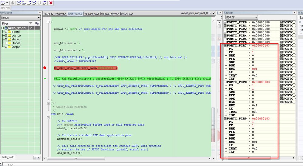

Good morning.
I am trying to use the  HW_PORT_GPCLR_WR without success.
In this stub of code the kGpioEncMux2 kGpioEncMux1 kGpioEncMux0 are the bit 9 8 7 of the PORTC.
The GPIO_HAL_WritePinOutput  works, but if I try to use the HW_PORT_GPCLR_WR it does not...
The bit of the register appear to be correct, but the output is different.
Suggestions???

kerryzhou
Hi Pietro,
    I check your code which you past,
  HW_PORT_GPCLR_WR( g_portBaseAddr[ GPIO_EXTRACT_PORT(kGpioEncMux2) ], mux_bits.val );
  This is not correct, because HW_PORT_GPCLR_WR definition is like following in our KSDK:
#define HW_PORT_GPCLR_ADDR(x)((uint32_t)(x) + 0x80U)
#define HW_PORT_GPCLR(x)  (*(__O hw_port_gpclr_t *) HW_PORT_GPCLR_ADDR(x))
#define HW_PORT_GPCLR_RD(x)(HW_PORT_GPCLR(x).U)
#define HW_PORT_GPCLR_WR(x, v)  (HW_PORT_GPCLR(x).U = (v))
x: is the base address of PORTC, it is  0x4004_B000. then x+0x80 =0x4004_B080
So, you should configure it like this :
  HW_PORT_GPCLR_WR(PORTC_BASE,0X03800103 );
This will configure the PORTC_PCR7, PORTC_PCR8 and PORTC_PCR9.
I test it, it can works ok on my side with HW_PORT_GPCLR_WR(PORTC_BASE,0X03800103 );
Following are my test result:
(1)Before run :HW_PORT_GPCLR_WR(PORTC_BASE,0X03800103 );
(2) After run ::HW_PORT_GPCLR_WR(PORTC_BASE,0X03800103 );
So, please modify your code and test again.

kerryzhou
Hi Pietro,
GPCLR is define the bits[15:0] of PORTx_PCRn, it includes pin mux control , pull select, pull enable,etc.
Did you configure your PTC7,PTC8,PTC9 as GPIO(MUX = 1), please check the according register:PORTC_PCR7,PORTC_PCR8,PORTC_PCT9.
Besides, check your GPIOC_PDDR, GPIOC_PDOR, whether you configure it as the output, and the pin out voltage is correct or not.
please give me your register debug picture, and your testing project.
Regards.
