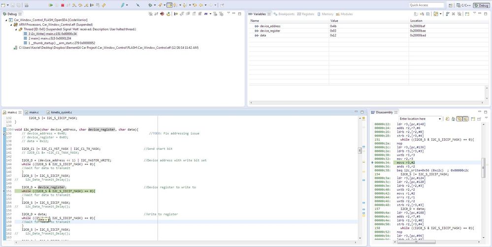

I have two functions to send I2C data and two to receive I2C data, one is for only one data byte and the other is for multiple data bytes. The issue is the single data byte function does not appear to be using the passed in values and I cannot work out why this would be. As you can see I have set the values of device_address and device_register in the functions to see if this prevents the I2C from hanging and it does. If I do not add these explicit declarations the code hangs at the first i2c_Data_Transmit_Delay(); in each of the one byte functions. Checking the passed in values of device_address and device_register they are both incorrect and appear  to be 0x98 which does not appear in my code and neither does 0x4C which would be 0x98 shifted right once. I have also attached a copy of the full code for further reference.

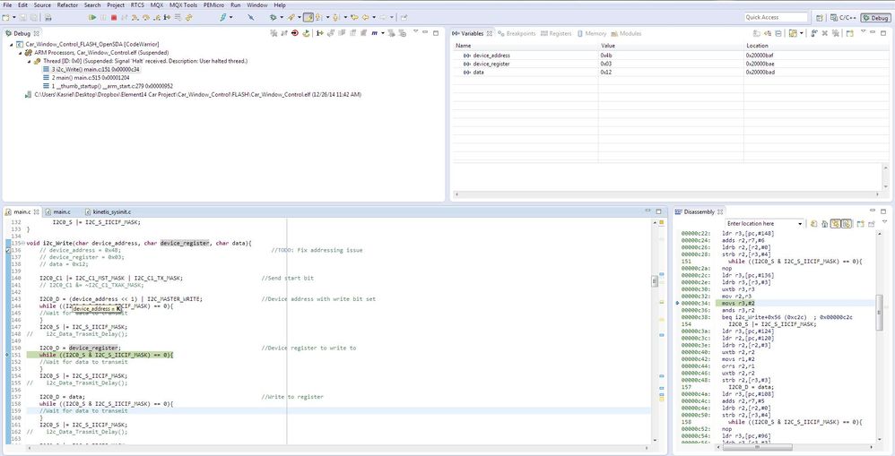

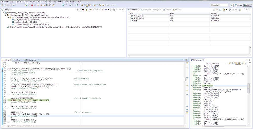

Point in the code where the i2c_wite() hangs and the values of the 3 passed values:
device_address value (same in both places)
18114_18114.jpg2014-12-26 11_45_23-Debug - Car_Window_Control_Sources_main.c - CodeWarrior Development Studio.jpg
device_register value (different from hover to watch window)
18115_18115.jpg2014-12-26 11_44_29-Debug - Car_Window_Control_Sources_main.c - CodeWarrior Development Studio.jpg
data register value (different from hover to watch window)
18116_18116.jpg2014-12-26 11_45_54-Debug - Car_Window_Control_Sources_main.c - CodeWarrior Development Studio.jpg
