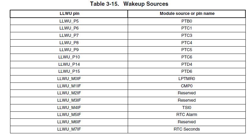

It is in the change from KL26 development board to the KL16Z128 that we are experiencing issues now, and specifically with sleep modes. We are using two different kinds of sleep mode:
  1. STOP mode for short period of time when connecting to an industrial wireless network. In this mode get woken up successfully by the UART interface with the KL26. However, with the KL16Z128, the UART wakes up the MCU, but all data on the UART turns into nonsense seen from the MCU. We remove the sleep mode (STOP) and the UART data is read normally again.
  2. LLS mode when sleeping for longer periods of time in between sensor measurement cycles. In this mode the MCU gets woken up by LLWU, either periodically by the LPTMR0, or occasionally by the UART TX RTS. This functionality works perfectly on the KL26Z, however with the KL16Z the MCU never gets woken by LLWU.

1. In the Rev doc, the UART is not supported as a LLWU wake source, so I'd like to know how you configure the UART to wake up the MCU from the LLS mode.
2. I was wondering if you can share the code snippet of configuring the LLWU wake source

Hei,
in the board layout we used UART_TX and have it not only connected to the UART input, but also to LLWU_P6. So it is the general LLWU pin that is used to wake up the MCU.
We worked around the issue of the scrambled UART data now by using WAIT instead of STOP while waiting for this data. It uses more power in this state, but fortunately in our case this case is rare. If one would depend on using the STOP state for power saving purposes and then read from the uart after waking up, then this would be a big issue.
