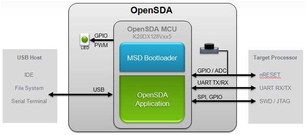

EarlOrlando
Senior Contributor II
Hello Tomas,
1) The USB is connected to the MK20 MCU which implements an USB CDC communication with the computer and for the other side is connected through UART to the MK64F so it simulate an UART connection through USB. The MK20 MCU programs the MK64F through the SWD interface.
2) This connector is for an external SWD interface, this replaces the MK20 interface.
3) The same as 2) but through the JTAG interface.
The problem here is that the application for the bootloader in the FRDM-K64F used as programmer must have the application for the K63F (or the target MCU, in this case K63F). Unfortunately, the K63F application does not exist so you need to develop it. If you are interested on that the post below will be useful.
OpenSDAv2
Earl Orlando.

EarlOrlando
Hello Tamas,
The FRDM-K64F has two MCUs, one is the target processor (K64F) and the other is the OpenSDA processor (K20). The K20 has a bootloader installed (the blue block in the image below) whose application (the green block) depends on the target processor. If you want to program a different MCU with the OpenSDA MCU you need to update its application (which is different than the program that will be downloaded in the target processor). The bootloader application is updated as is explained in the following post from Erich Styger in the section Updating board firmware. That bootloader application is the one that you need to create specially for the K63F MCU.
Illustrated Step-by-Step Instructions: Updating the Freescale Freedom Board Firmware | MCU on Eclips...
https___community.freescale.com_servlet_JiveServlet_showImage_102-100720-7-11446_pastedImage_6.png
If there’s anything else I can do for you please let me know.
Earl.
