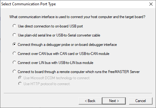

Hi, all
I bought  a  MKV10Z16 for FOC control a robot in-wheel motor.
I have ST-LINK, so I tried to connect MKV10 and freemaster with that but failed.
I can't even connect or check whether its running,
any tutorial or example for starting freemaster?
Thanks.

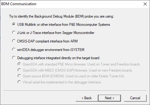

Hi Frogram,
I didn't find the ST-LINK in the list of debugger probe of FreeMASTER Connection Wizard.
Connect through a debugger probe or on-board debugger interface.pngConnect through a debugger probe or on-board debugger interface.png
Try to identify the Backgroud Debug Module (BDM) probe you are using.pngTry to identify the Backgroud Debug Module (BDM) probe you are using.png
I don’t know if ST-Link has a USB to UART function, if so, you can try to choose this connection method.
Use plain-old serial line or USB-to-Serial Converter cable.pngUse plain-old serial line or USB-to-Serial Converter cable.pngProbing UART Ports.pngProbing UART Ports.png
We have a FreeMASTER community forum, I suggest you go there to ask questions and get more accurate answers.
