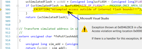

If you open the project in Visual Studio and run the simulator it immediately shows you the problem:
#define UTASKER_APP_START     (32 * 1024)   // application starts at this address
#define UTASKER_APP_END       (unsigned char *)(UTASKER_APP_START + (128 * 1024))
Since your chip has 128k of flash the application range is too large. What is happening is that there is a check at startup to see whether this range is blank and that crashes when checking beyond the end of flash.
The reason why you didn't see this when you had non-blank flash is because the check already quit since it had already found non-blank content - meaning it don't have to check so far and find it crashed.
Since you have RUN_FROM_HIRC enabled it overwrites the crystal settings (if you look carefully you should find these defines are not active and are displayed grayed out by the editor).
Therefore it will be Ok if you change the application size to
#define UTASKER_APP_END           (unsigned char *)(UTASKER_APP_START + (96 * 1024))
for example.
Or
#define UTASKER_APP_END           (unsigned char *)(SIZE_OF_FLASH - UTASKER_APP_START)
will work if you automatically want to use all remaining flash (although often one keeps an area for saving parameters to that is preserved across firmware uploads).

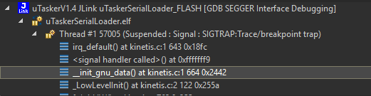

So i debugged bootloader and it hangs at irq_default causing hardfault. If u need more detailed photos i can provide them. Attached not working binary.

The debugger shows that the processor is crashing when it initialises its data (bss - i.e. variables initialised with the value 0, or initialised variables - ie. the ones initialised with non-zero values from const memory). Since the serial loader uses minimum error handling vectors (defined _MINIMUM_IRQ_INITIALISATION) all of the error interrupt (like hard fault) will lead to the irq_default() being called.
This hard fault is typically seen when the wrong linker script file is used - one which locates variables to start at an address that doesn't exist in SRAM. Then the gnu data initialistion hard faults when it tries to copy 0 to .bss or to initialise other variables.
I have attached the linker script that I used - it is however the same one that was in the GNU directory that is in the Github repository. Maybe you simply used the wrong one or you somehow lost the setting to the one that was working(?). You can also use the map fie to see whether the .bss and .data sections are location (these areas are defined by the linker script file) so that you can see that nothing is located either below 0x1fffe000 or above 0x20003fff. Post your (from MCUXpressor generated) map file if not sure.

No idea how this happend but my linker script went back to default one, after changing it everything works fine.
