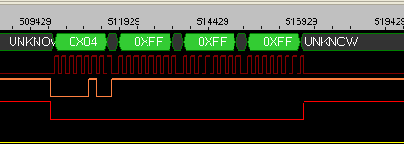

  I'm trying to send 4 bytes block using SS1_SendBlock() function generated from PE. Problem is, that only first byte from 4 is send with data, rest 3 is 0xFF.
I'm trying to send 1,2,3,4 and i get (repetable):
0x01 0xFF 0xFF 0xFF
500ms delay
0x02 0xFF 0xFF 0xFF
500ms delay
0x03 0xFF 0xFF 0xFF
500ms delay
0x04 0xFF 0xFF 0xFF
500ms delay
I'm using CW 10.4 and Freedom Board with KL25Z 1N97F. Do You have any ideas ?

From looking at your screenshot of your SPI signals, I see that you are not toggling the SS line after each byte transfer. Unless the slave receives a high SS input after the byte is sent, it will send whatever is present in the SPI data register, which is the received data from the MOSI line. If SPI MOSI is high by default, the slave will transmit 0xFF after the first byte transfer. Let me know if toggling the SS line after each byte transfer solves your issues. Thank you.
Martyn

  You are right. Device that is trying to read from FRDM Board is Kinetis K60 in TOWER and MQX 4.0.1. I don't know why it is not toggling CS after each byte reading. I'll try to divide fread() to single bytes and let You know how it works.

  thank You for Your help. Where in KL25Z documentation is mentioned that each SPI byte has to be separated with CS idle state ?

Glad I could help! As far as where in the documentation, section 37.4.5 'SPI Clock Formats' of the KL25 Reference Manual explains that SS must go high after each transfer for SPIx_C1[CPHA] = 0.
