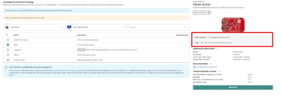

is it possible to add FreeRTOS to a mke04z8 microcontroller?
Usually in other boards there is a FreeRTOS template for it.
I check the MKE17z and there is a template for FreeRTOS.

Hello @carlesls ,
Thanks for your post.
In versions earlier than SDK2.5.0, you can find FreeRTOS examples. Refer to the figure below.
For example, SDK 2.4.1:
Wish it helps. If this post answers your question, please click the "ACCEPT AS SOLUTION" button. Thank you!
