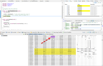

It is not perfect for cases where an overflow happens because of a not (or not fully) initialized buffer. This could happen for some communication stacks. Below a screenshot of an example showing this:
Marked in yellow is the stack allocated, and the application overflows and writes a 0xdeadbeef on the stack outside of the allowed area, and this is likely not detected.
Because detection method 2 happens at task context switch time, and if the SP (or PSP) goes above and beyond but back again and then the context switch happens, it is not detected.
I have to say that chances for this are not high, but if you know Mr. Murphy then you know it will happen.
That's why in addition to the runtime checking I do static checkings as outlined with the links mentioned, and this is why I like that stack size count in the MCUXpresso IDE so much: it gives me something else to look at:
