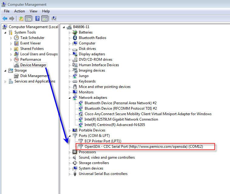

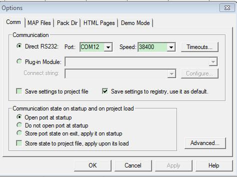

    2,Actually, the connection between the FreeMaster and FRDM-KL25Z is the uart0, so you should choose the correct COM and configure the baud rate to 38400.
    you can configure it in the freemaster softe: Project->options, then like the following picture:
  you can find your com port from your computer management, like the following:

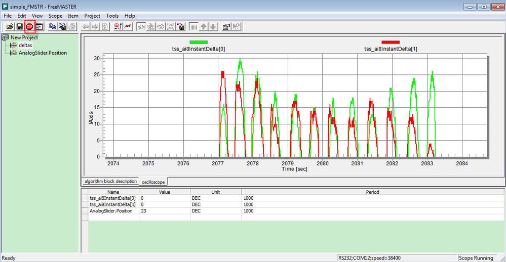

then start the freemaster,  and touch the slide in the freedom board, you will find the freemaster scope like the following:

Thanks Jingjing, the example works great now!
It actually worked with both the PEMicro MSD bootloader, but also with the PEMicro debug app (as well as the latest integrated version 114 from PEMicro) . I guess that's because they both implement the serial pass through.
