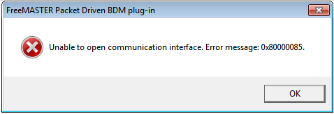

 Hi everybody,
I am trying to use freemaster with USBDM. The scope worked ok, but I need more speed.
So, I included the files from the freemaster library, set the FMSTR_USE_PDBDM, and the FMSTR_Recorder() and FMSTR_Poll() functions are being called from a loop in the main function. But it doesn't work. When configuring FreeMaster,  It starts scanning if the button Search Address is pressed, but at a certain point I always get the following error:
If I click Test Connection in the "Packet driven BDM communication" window, I get the error:
Any ideas on how to solve it?

About FreeMaster Error Message: 0x80000081
In the freeMaster option menu you have most probably turned on the BDM connection and the communication is working fine. And then you want to turn on the recorder and you see the error as you describe. Now the reason of this is that the BDM protocol doesn’t need the recorder. To use the recorder you would need a software in the MCU. You should better use serial line connection when you want to use the recorder.
About FreeMaster Error Message: 0x80000085
Please refer below thread:
https://community.nxp.com/thread/68839
Wish it helps.
