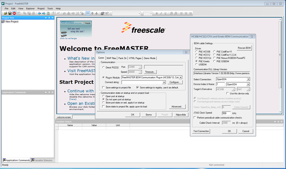

Open FreeMaster and  go to Project/Options/Comm, use setup from picture below
Choose Plug-in - use the FreeMASTER BDM Communication Plug-in, hit configure and take P&E Kinetis.
you can test the connection there too.

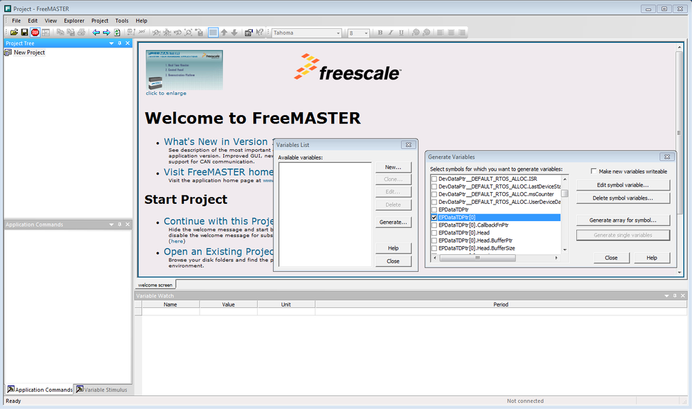

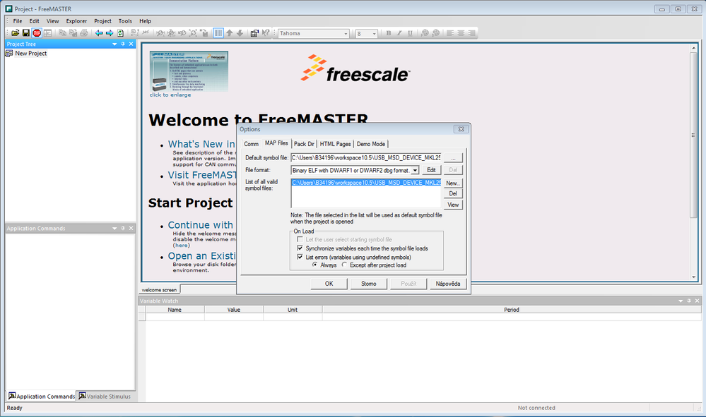

The next step is to go to Options/MAP files, navigate to *.ELF file of your project and set file format to ELF/DWARF (I have chosen .elf from some usb demo project just to show the way how to do so)
well, the connection is established, now there is need to choose variables for display and visualization.
Go to project/Variables and choose variables you want to follow (hit Generate.. to do so, list of variables available in your project will appear and you can choose the desired one and hit generate - it will check and generate the variable connection, you can do it for single variable, array or more variables - it is intuitive )
When desired variables are generated, close the dialog.

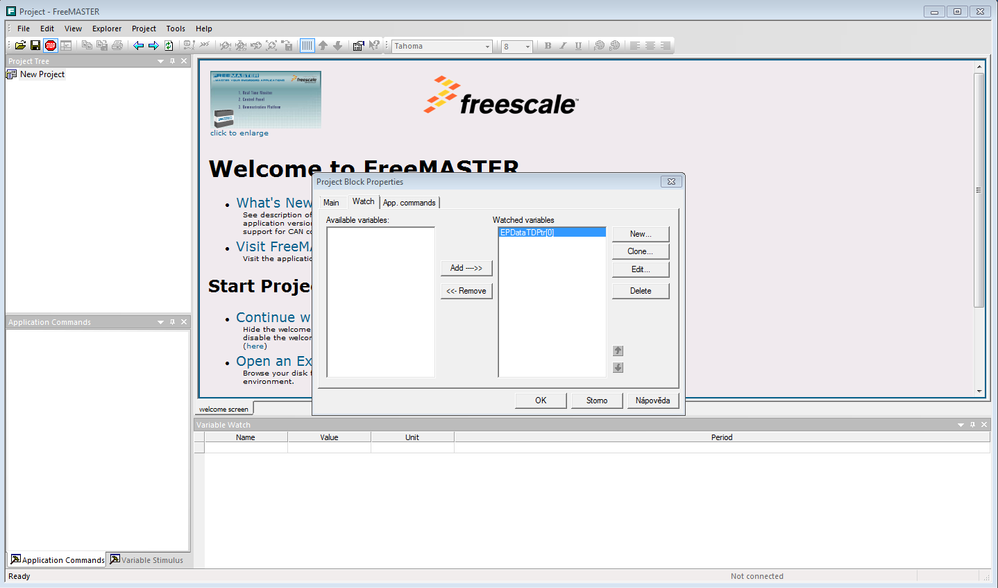

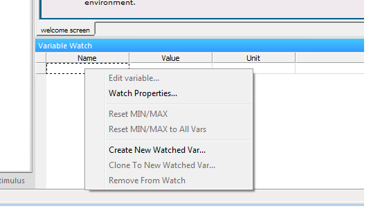

To add variable to variable watch window click by right mouse button in watch area
go to watch properties, Watch tab and hit Add---->> to add it between watched wariables and hit OK
and value appears in the Variable Watch window.

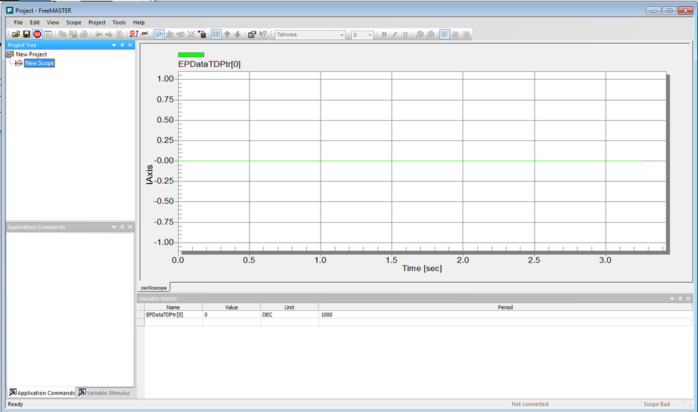

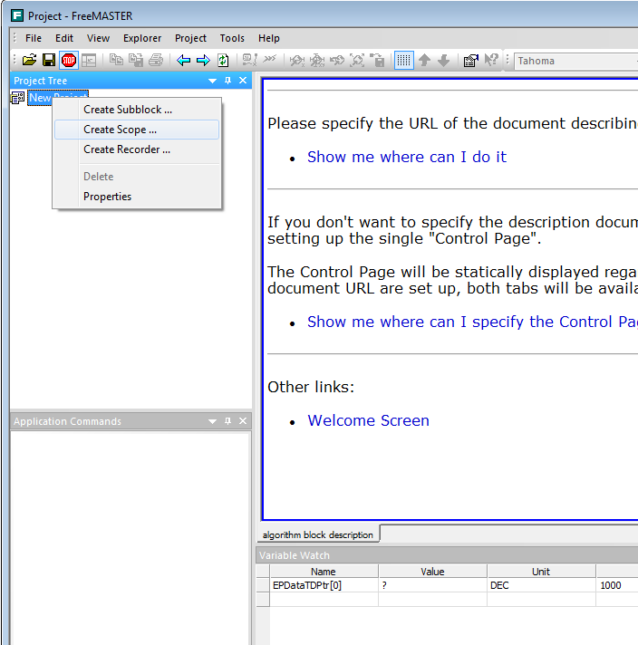

To create scope, go to project tree window and use right mouse button on NewProject, choose Create Scope...

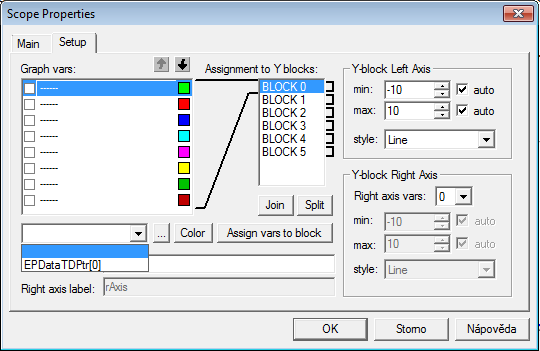

In scope properties chose the name for this scope and go to  Setup tab. You can add your variable to the scope here by choosing in drop down menu
Hit OK and start the session (Ctrl+K) or hitting Stop icon in the menu, the variable is displayed in the window.
The value in my case stays 0 however displays correctly...

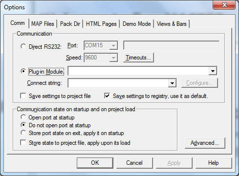

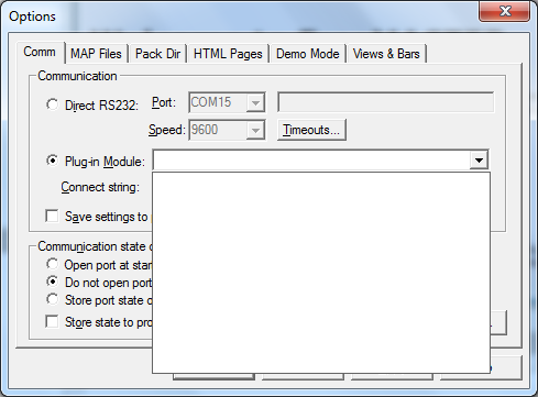

Hi Paval,
Just want to let you know that I did try on Options under Communication Tab to select S08 BDM / Kinetis OSDA Plug-In,  but there is no plug-in shown (see screen shots below):
Thanks.
