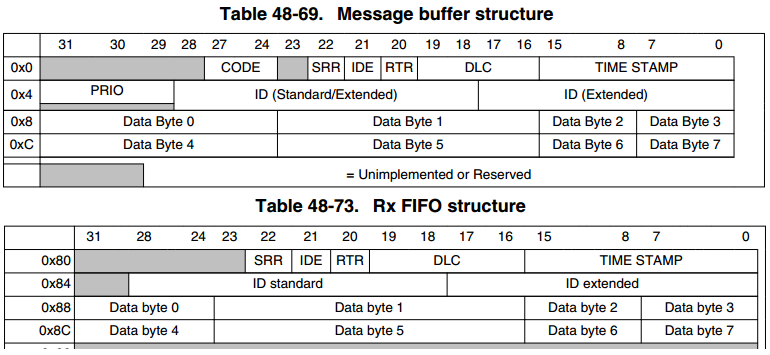

I use MK24F12. I adjusted Flexcan module to gather messages from device using Fleet Management Systems Interface.
I turned RxFIFO on and set ID acceptance mode as Format A. Then i filled filter table (it starts at 7th mailbox) with IDs and according RXIMR registers with Mask. The rest filters i filled with 0x40000000 and the rest mask registers with 0x5FFFFFFF.
When i start to listen to device i get some frames, but here's the problem i don't get all messages device sent, despite they match filters.
i know that because if i set any mask register as zero i get all of messages on bus.
i noticed that hit filter (RXFIR register) is (0,1,4,5,...), so in other words i get messages which match filters that stored in registers CSn and IDn of MailBox.
Below is log, here i added 7 filters and i got just 4 types of messages. Then i removed all filters and as you can see i skipped a lot of messages that supposed being caught.

I have found that I read CODE bits of MB's CS register and it was 1 for filters 2,3,6,7... that means BUSY. But if MB is used by FIFO engine it doesn't contain CODE bits and we shouldn't check Message Buffer Code at all.
They might if don't use some bits keep them clear.

Hi George,
Checking the CANregisters.png, looks like the value setting for RXIMRn has some issue, Did you use the following macro to set the mask value?
#define FLEXCAN_RX_FIFO_EXT_MASK_TYPE_A(id, rtr, ide)                          \
    (((uint32_t)((uint32_t)(rtr) << 31) | (uint32_t)((uint32_t)(ide) << 30)) | \
     (FLEXCAN_ID_EXT(id) << 1)) /*!< Extend Rx FIFO Mask helper macro Type A helper macro. */
so you will left shift 0x00FFFF00 by 1 bit before feeding it into the RXIMRn, which should be 0x41FFFE00 at last.
Please try with this macro and kindly let me know if the issue is still there.

georgemakarov
You are right! I forgot to shift mask left by 1 bit.
I has written code to work with FIFO by myself based on Processor Expert code, but not KSDK
